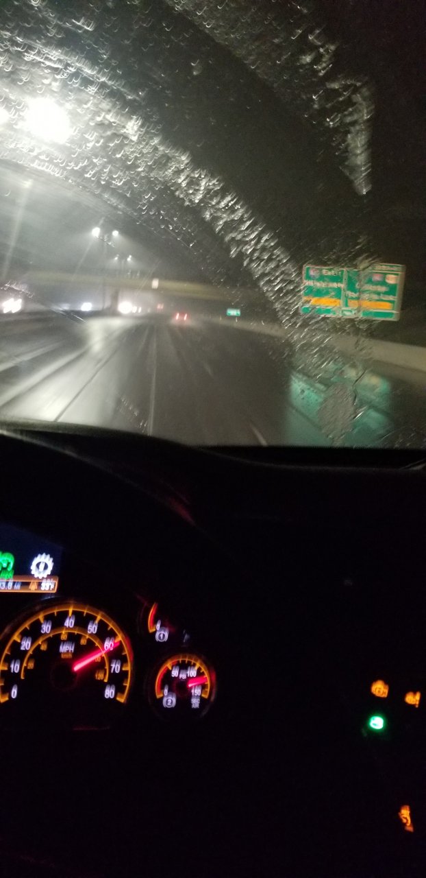

    Does anyone out there know of any wiper blades that aren't susceptible to leaving streaks of slush on the windshield?

    It's not the blade so much as the arm. I've tried "good" wiper blades but they don't seem to do much better than the cheap ones.

    It's also good to clean your blades when you clean the window. Just use a wet paper towel or whatever you have and clean any dirt and grime that's on them so they don't streak because of something's on the window.
    Also, I use rainx...I apply it to the windows and in the cleaner itself.

    I am using new blades.

    That being said, I think alot of it comes from "road grime" stuck on the windshield and wiper blades.
    Pick up a spray bottle that you can fill up with water and add a small amount of dish soap Into. It only takes a few drops. 4-6 drops the first bottle then maybe 3 drops the following.
    Grab a brass pottscrubber (Loves sells them), one of those "sponges" for washing dishes with the abrasive green side, or some 00/000 steel wool pads and use them to scrub the windshield the first cleaning. You will feel resistance and bumps the first time you clean it, just keep going until it is smooth and not bumps when you scrub the glass.
    Pickup your own squeegee and only wash the windshield with that bottle of dish soap and water, also wipe off the wiper blades. Try to avoid the truck stop buckets and squeegee and the fuel island, It sounds like overkill but it helps alot. Truck stop wash buckets are full of blue water, mayb some antifreeze, and whatever fuel, DEF,grease good old Joe just wiped off thier truck.
