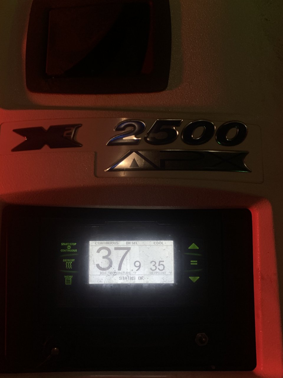

    Hey guys. Just purchased a 2013 wabash with a carrier. The box temperature is always 3 degrees lower than the set point . Regardless of what I put the set point at. What could be causing this issue. Is this something that could be rectified by bringing the unit and getting it serviced ? Thanks

    How are you verifying box temp?? Gauge could be off. Also is it on continuous or cycle ? Cycle will allow more temp swing

    Well I actually haven’t tried to verify the box. I’ll try that tomor . I have it on continuous

    Try running it off continous to see if it reaches set point and shuts off. If not you need to get the reefer serviced. The temperature gauge could be off as well.

    On that apex micro system you can go into higher access(see youtube for how to get into it) there might be a setting for modulation mode you can adjust, if not then when it's due for oil change I would take it to carrier and tell them to check it.

    Thank you sir. I’m going to take it to carrier. They are just so booked out these days !
