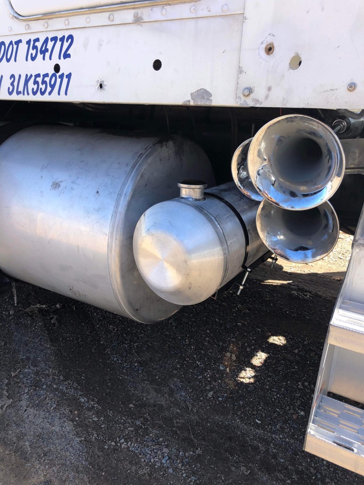

    i bought an 8 gallon spun aluminum tank off eBay for $110. It’ll run for a week before I gotta refil.
    Also…, at the end of your season running it, put it on full blast and run a gallon of kerosene thru it. I’ve had mine for 6 years now, previous one went 8

    Why do you need a separate tank?
  8. Hammer166
    7,617
    27,867
    Aug 18, 2007
    ~8600+' and loving it!
    Yeah, unless you were running the heater on kerosene or jetA all the time, it's just something else to worry about.

    i need that tank. how to find it on ebay?
