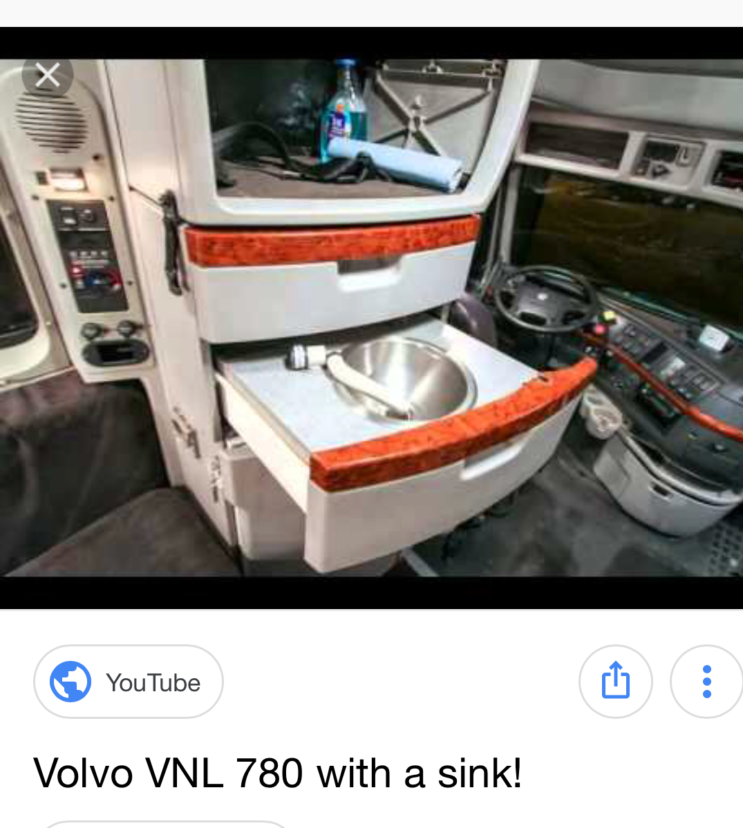

    I've restored some VW Westy campers and I came across this setup years ago. Cheap and simple submersible 12v pump with a faucet that has the switch built in it. Cold water only.
    Sink Water Pump
    Sink Faucet
    Mine sink is a stainless steel bowl with a low profile drain in a drawer in my Volvo. I saw pics of this done online and copied the whole setup. I think it was or is a Volvo option. Tank, as I said earlier, is just an Aquatainer (blue) water jug from Walmart. I fill it up at home with the hose or gallon jugs every couple weeks.
    OP, I realize this has nothing on the full sleeper but figuring out the comforts of home in a regular condo sleeper is all I've needed so far.
