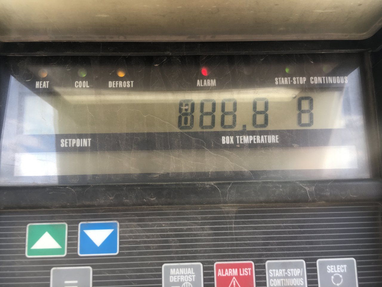

    where can you find the manual? I’ve spent the day trying to figure out why this screen is locked up in the “start up flash” 0BA7557F-A1EC-40E3-9DE2-9514C84043E1.jpeg

    Just Google it. I sold my trailer weeks ago. I looked in my phone for it but I must have deleted it

    Google has it in PDF downloadable

    I ended up buying a new control panel and everything was fine after that. 398FC7BD-6327-40EF-BAEB-C10299280864.jpeg

    Glad you fixed it. I am thinking it was around $2000 is that correct?
