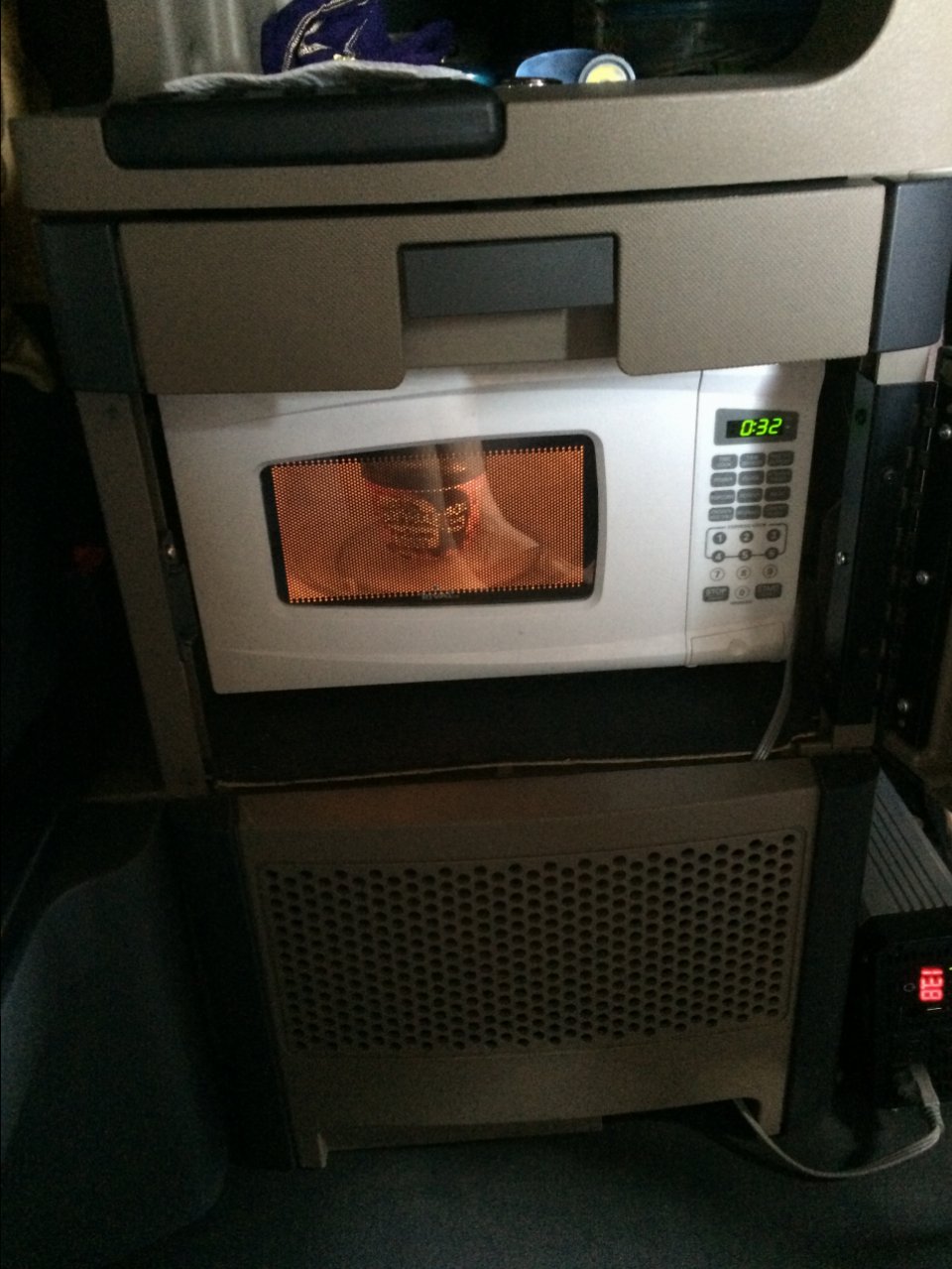

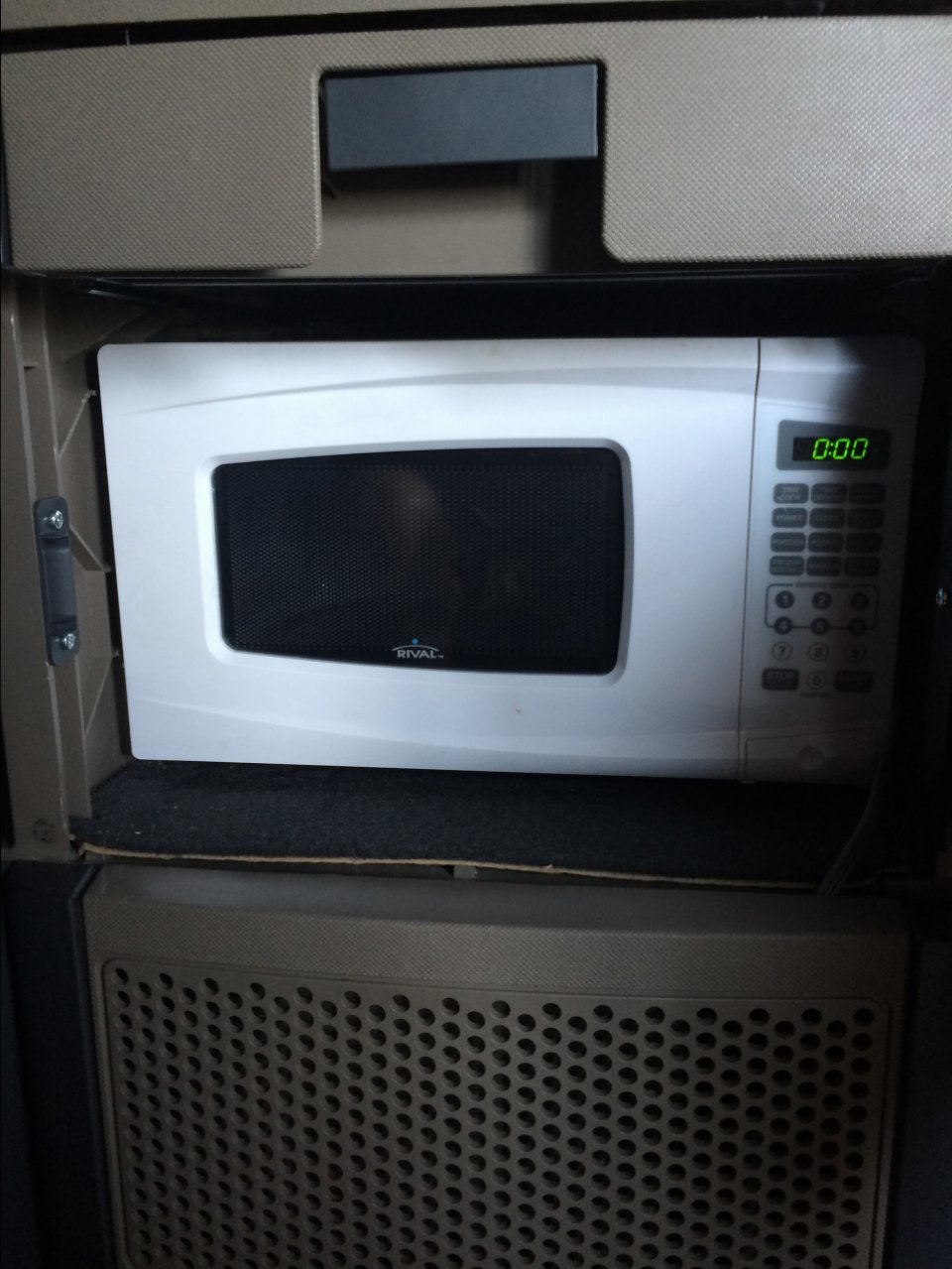

    I have a 2015 cascadia and had it strapped down on top bunk until I figured out a better way
    This is a Rival 700w sub 50.00
    microwave from Walmart
    What I did was pulled drawer out
    On each side of slide rail is a metal tab that can be depressed to separate drawer from rails
    Next I removed the door and striker plate
    Next I raised lower bunk if you look along edge that the bunk rest on you will see three screws remove these as well this will allow cabinet to flex enough to slide microwave in
    Put removed parts / screws back in place took me ruffly 30 min

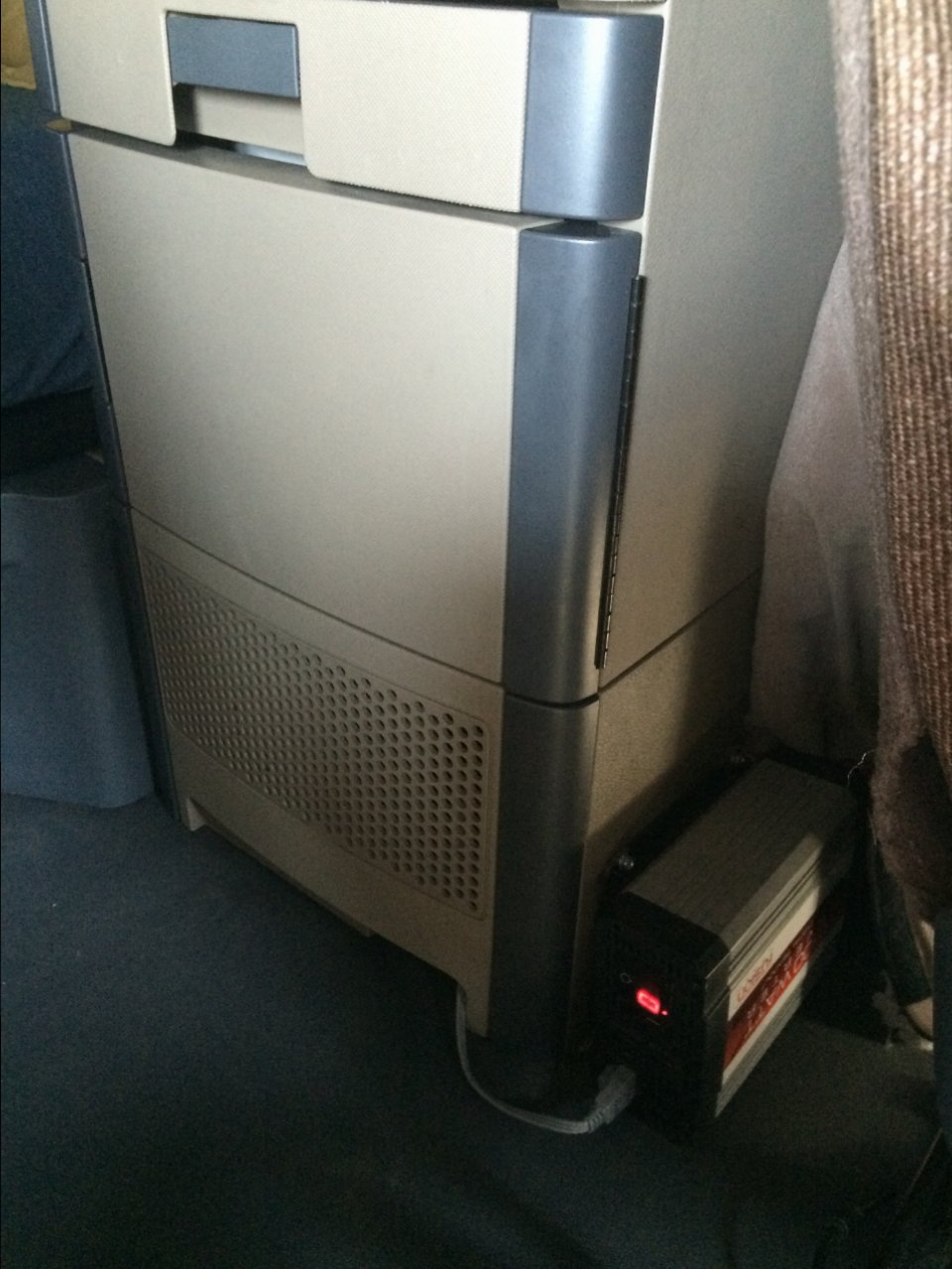

    Our company would only let us have a big inverter if they install it to many people melting wires by bad installs it's a 1500w from Napa auto works great mounted behind drivers seat .
