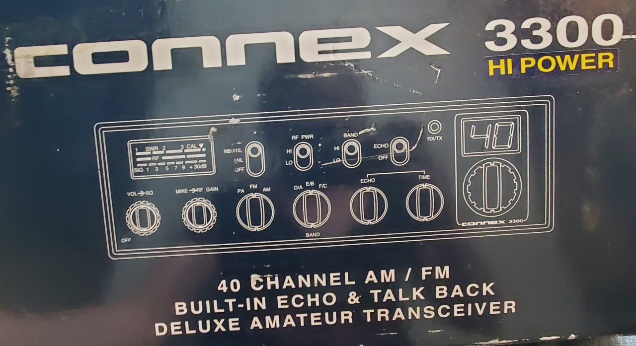

    20220421_200443.jpg I don't know much about CB Radios, but I was given this by a friend. Can anyone tell me a bit about it? Details, etc....how it works please :) And no I am not looking to sale it or give it away ;)

    10 meter radios can be converted to run CB frequencies. Stryker, Galaxy, Quad5 are all 10 meter, but changing a jumper position and tweaking a couple settings makes them CBs.
    Once upon a time there were rumors of the FCC walking by trucks with meters to see who was putting out more than 4w, but all those rumors pretty unsubstantiated. I run a 150w Galaxy and have run 200w Strykers.

    Find a reputable shop and have it converted to CB. Don't just roll up to the first shop you see, there are too many people who took an online electronics course and got busy screwing up radios "learning while earning".

    That 3300 is a good radio if it's been converted for CB instead of 10 meter. I have the General Lee version and it's a nice setup.

    Good radio
    Forget the peak and tune crap, don’t believe it makes the radio work better, most of the time it doesn’t,
    find a good shop that will make the conversion and properly align it for you the right way
    focus on your antenna, don’t get into the trucker type big rig good buddy dually crap, go with a single antenna and good coax with good grounds to support the antenna system - you can learn a lot from the cb forum here.
    the radio is 20% of the signal, the antenna, proper ground and coax is 80%.
