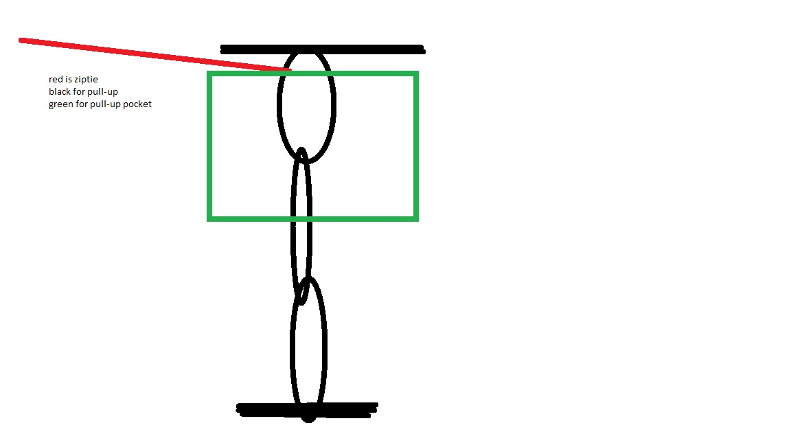

    a simple solution to using pull-ups in winter weather is to put a ziptie on the first link below the cap with the tail sticking out so you can it grab with a gloved hand.

  8. Tb0n3
    Tb0n3 Road Train Member
    4,738
    9,652
    Oct 5, 2012
    Earth
    Masterpiece.

  9. ETMF 58 White
    ETMF 58 White Light Load Member
    90
    219
    Jan 4, 2019
    That’s a good tip to pass on to the next generation of flatbedders. My daddy didn’t show me that trick because, well, we didn’t have pull-ups back then.

  10. adayrider
    adayrider Road Train Member
    1,289
    1,732
    May 7, 2018
    It works for a little while but wears off from going down the road.

  11. beastr123
    beastr123 Road Train Member
    2,952
    24,211
    Jan 2, 2014
    Moose Jaw SK CAN
    Zip ties are cheap and can be replaced when you get to warmer weather.
    Mine lasted for about 6 months and then it was warm enough to replace them one day while waiting for dispatch to get the lead out.
