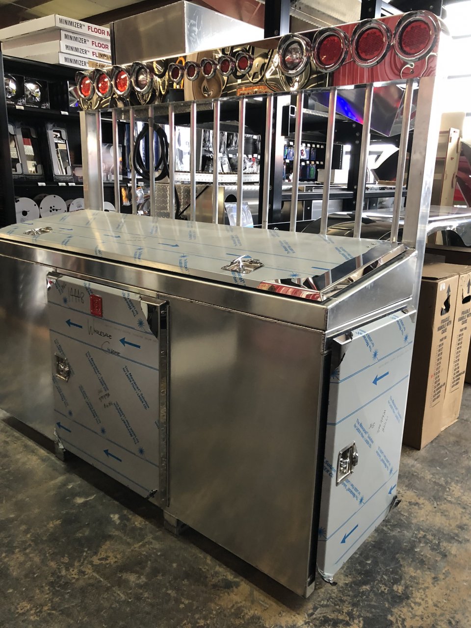

    I can't see under your neck. My stepdeck I have boxes by the landing gear. 1 each side. IMG_20190403_152623779.jpg

    Without reinventing fire(they did that a few weeks ago)..... does anyone make a metal platform that would fit across the width of the catwalk, over the frame of a 2019 Freightliner that can support the weight of 8 chains and secure (both for anti theft and safety)? The width of the existing catwalk isn't enough without leaving chain hanging over the edge or putting too much weight over the center.

    I was talking to a flatbed driver the other day and idont know how true this is but he was saying at the iowa 80 truckstop they are selling boxes that fit down inside the frame in the catwalk, that have a tunnell to fit over the driveshaft and the boxes fit inside the frame rails there and can lock em . he said he ordered one for his kenworth, the way he was talking about it, it sounded pretty cool..
