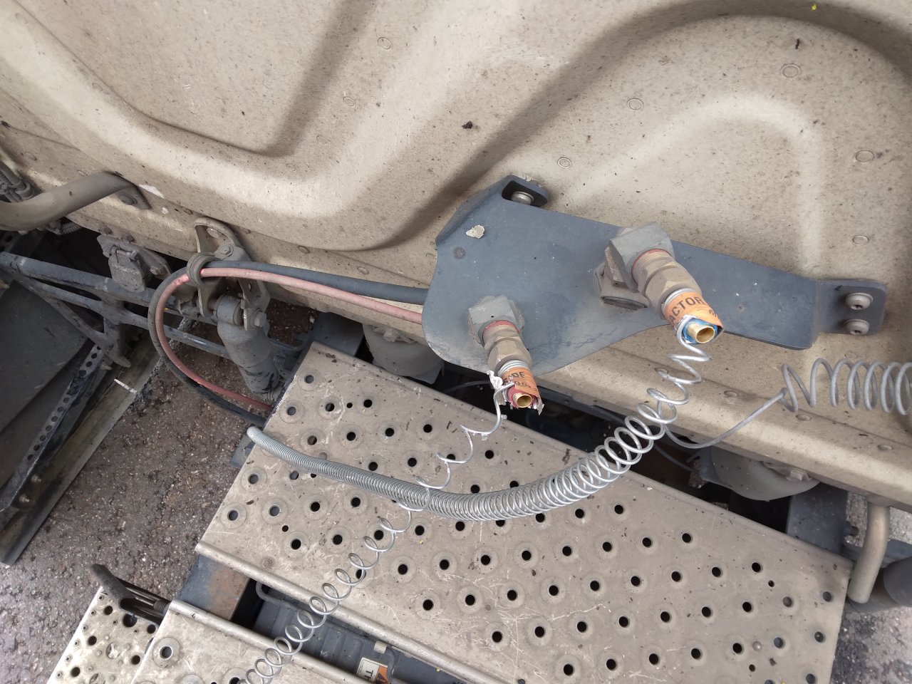

    When mine blew, it took out the airlines too....in a 2 lane construction zone. Good times...good, good times.

    Wonder if we can get Goodyear, or Bridgestone, or Michelin to put those pictures on their websites.
    A real sales tool...
