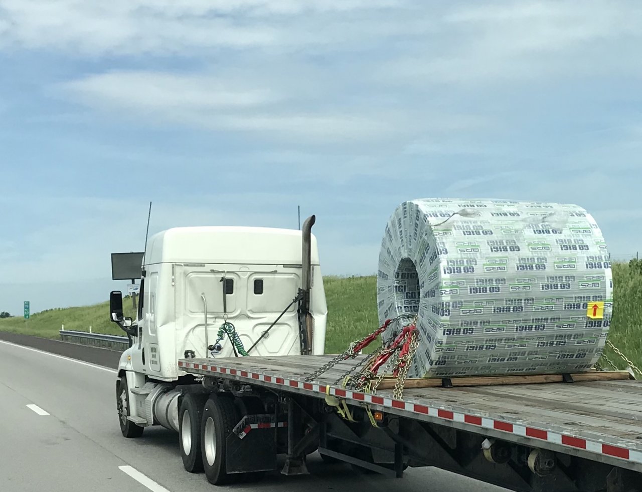

    A5904B2D-EC31-4A55-AC7A-3D178B512B8C.jpeg So, a buddy sent me this one.
    Note - brand new chains. I’d have gone 3 forward and 4 back, but whatever.
    Note the back of the sleeper.
    Now - the comedy part - 10 points to anyone who can guess the name of the company - out of Osceola, AR.

    That's one GIANT roll of sheeeit paper .....

    No - but that’s fitting.

    I asked a question like this before.
    If you have one chain forward and one chain backward would it be better than two chains pulling down on the middle?
    The coil needs to go over the coil timber to roll forward. it will need to go up before it goes forward. Would one chain pulling from the back be good enough? Or two chains pulling down on the middle preventing it from going up to begin the forward movement?

    Are those landscape timbers? ohh no!

    The problem is securement points. If they're all tied in so close the rail might get overstressed in that area, or even just have nowhere to work.
