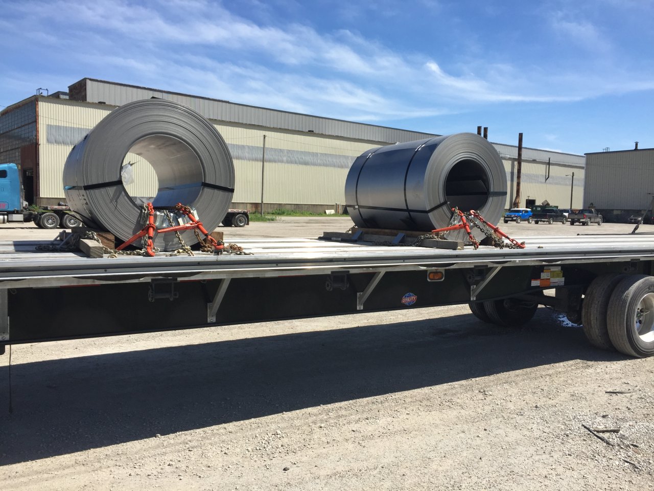

    What a great picture. I wonder if it was that specific drivers handy work that left that nasty crease in that sleeper? If So I bet he learned a lesson. Also I'm also wondering if his bunk is crooked or lopsided now? Serious question...sort of.

    One at each end at an angle less than 45 degrees -- per the regs.
    Here's the myth that will be busted: The people that wrote the regs aren't stupid. There's a reason they wrote it that way.

    Not enough chains?

    Depends on the coils and the racks. Even on a, say, 10,000 pound coil, there can be variations in the size. So, it depends on how deeply it sits in the coil rack compared to it's size. But I would probably go with the chains out at an angle. For my money, that's the better securement, unless it's a pretty small coil in a rack with really good sized timbers.

    Coils should be secured from the center out. Chains pulling straight down. Keep the coil in the rack and it’s not going anywhere.

    See, I'm perfectly happy with that securement. The size of those timbers, the size of those coils, they would have to roll nearly straight up to go anywhere. I like that securement. It just isn't how the regulations tell you to do it.

    Actually it is exactly how the regulations tell you to do it.
