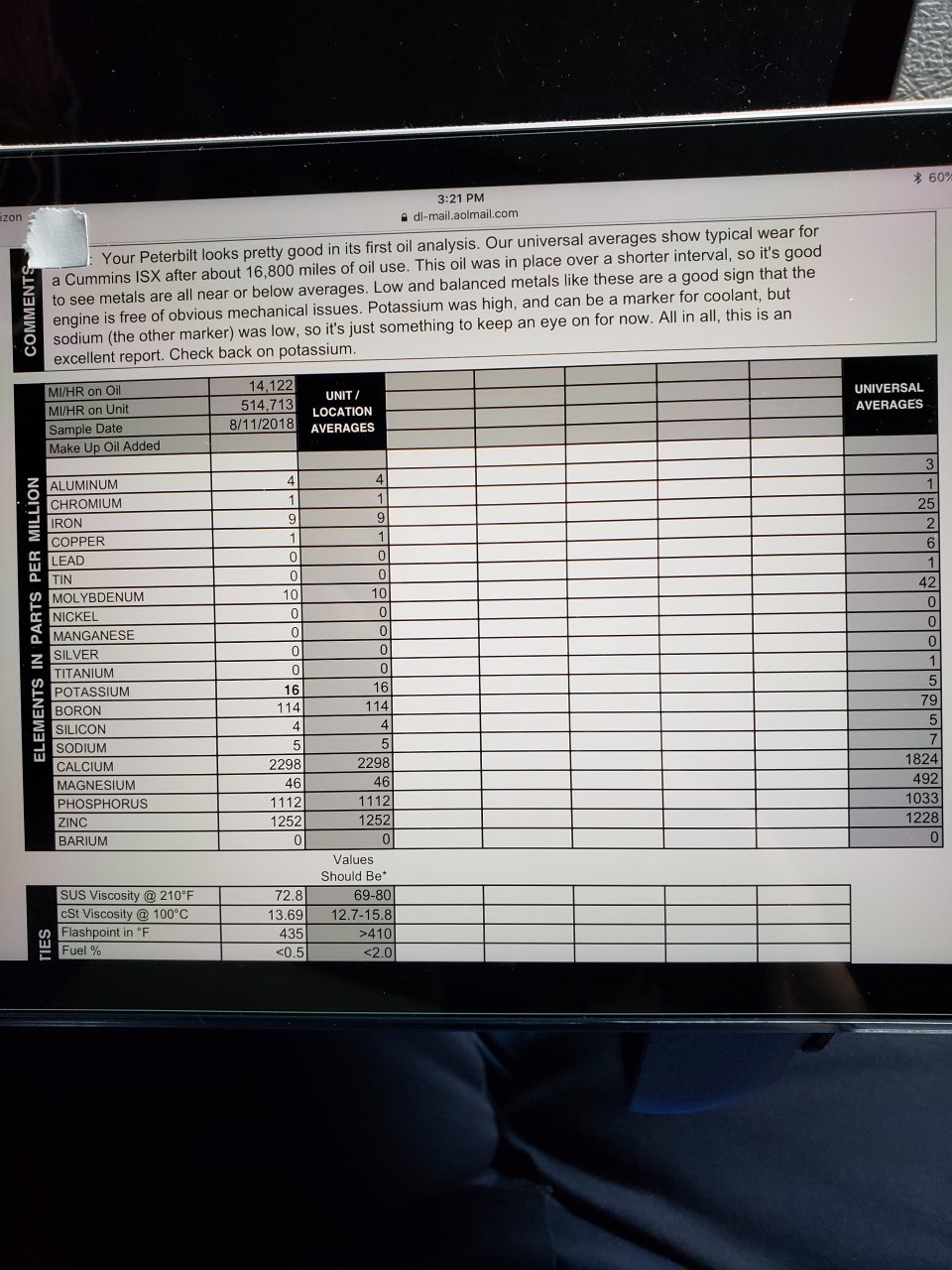

    I don’t see glycol on that report . My report from Eurofins does but it doesn’t show potassium I’m wondering what is the best company to use. Eurofins took so long to return report good thing I didn’t have problem.

    I've never heard of them. Blackstone is in Fort Wayne, Indiana... They will mail you the sample kit free and then when you send it you include check or credit card payment... I believe it was $23... took about a week after they recieved it for results although if needed quicker they have a section on the paperwork where you can write in that you need it ASAP and they will have it done same day for you.

    Your potassium isn't alarming yet. Another source of potassium in oil analysis is in the flux the use when manufacturing the charge air cooler.

    No way I would be dropping the pan on this engine with only a gallon between oil changes. Trying to give this guy a heart attack?..... Not without evidence of cross contamination or at least an oil sample showing such.
    These liners dont cavitate and get holes in them like they used to unless your really bad at maintaining your coolant.

    Cummins guidelines on oil analysis.
