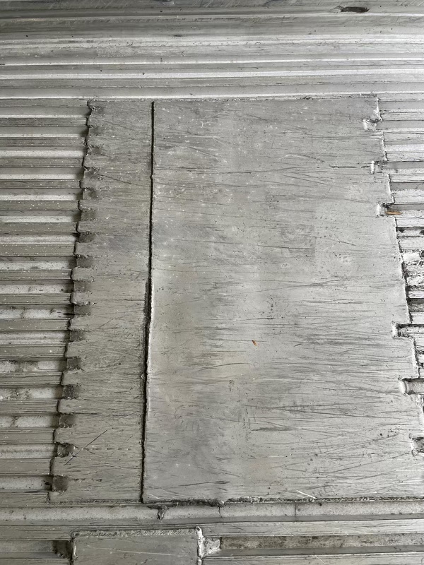

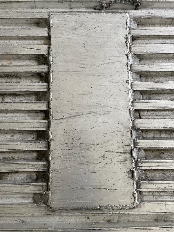

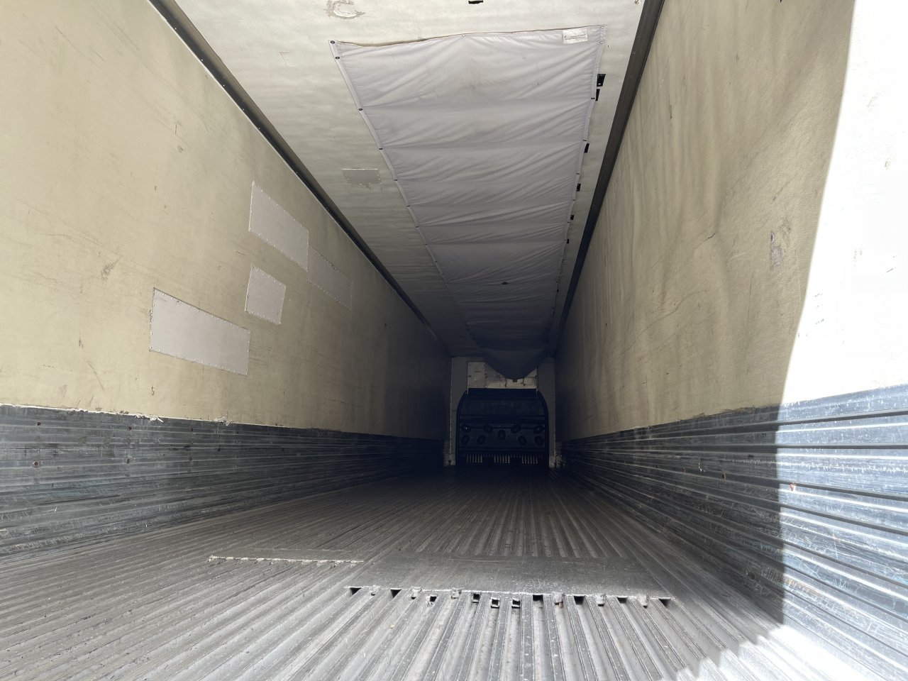

    We have had to do that with a few of our reefers. looked a few times to make sure it wasn't it wasn't one of our old ones.
    Heavy loads and forklifts flying in the trailer will kill the floor over time.
    Once it starts cracking out, it will keep going unless they repaired the surrounding sub flooring as well.
    Consider this trailer disposable and should be priced accordingly.

    I wont have this trailer even if owner offer it for free. I have had trailer with cracks but it's was repaired very differently. Looks like nothing left under aluminum. Cross members probably rusted out. Have seen one O/O in NC cucumber farm got trailer floor side fall down when forklift put last pallet.
    This trailer is junk.

    No its not a problem. A friend of mine had a similar type of patch and he had the trailer for 6 years or so. You mentioned you are getting a deal. What type if trailer, reefer unit and hours?

    I've seen many reefers with stress cracks in that particular area that hauled heavy loads and they didn't slide their tandems when getting loaded/unloaded. I even saw one reefer tail end break off at that same spot that had already been welded a few times when they were unloaded with the tandems forward.
    If you don't slide your tandems back at a dock, it's just a matter of time before this happens. Don't be lazy, slide them back.

    Another problem with that type of repair, is it's very hard to pull pallets to the rear with the clamp and chain if they dont have a dock.
    Palllet will hook the raised repair every time.
