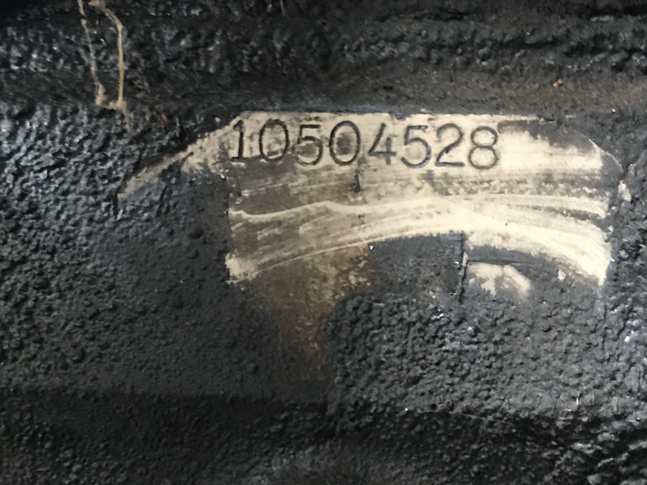

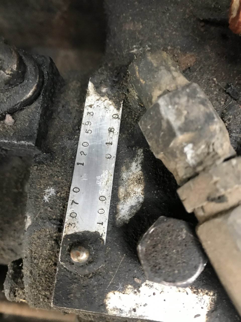

    Tag was gone, I took a pic of the ser # & pump code but forgo to check it out lol..... C2CADE22-1EA0-4B6A-BAB7-716835DEE29C.jpeg 18C74F9F-0EE3-4FBA-A0FE-CF8A6C6C7D5B.jpeg

    Is it possible your uncle built it to 420 specs? Pop had an A model KW with a 350 converted to a 420 and it ran real good....

    Yeah I thought about that but it starts way to easy and good and doesn’t lope and smoke like a 420 when cold.
    I’ve been told by others that it has a distinctive sound that other 350’s don't have. I think it may be the pulse manifold and shwitzer turbo on it doing that.

    Looks like cpl160 on pump tag
    Cpl 160 is supposedly the best and most reliable 350 cpl they had. Thats what all 3 of his ‘74’s had.
