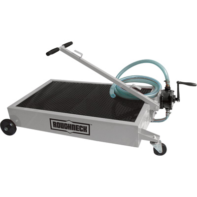

    Two things:

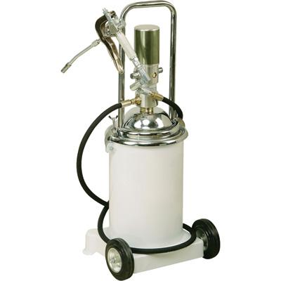

    -something to catch the oil. I use one of these.
    -a grease gun. I got tired of having to change cartridges all the time, so I got one of these.
