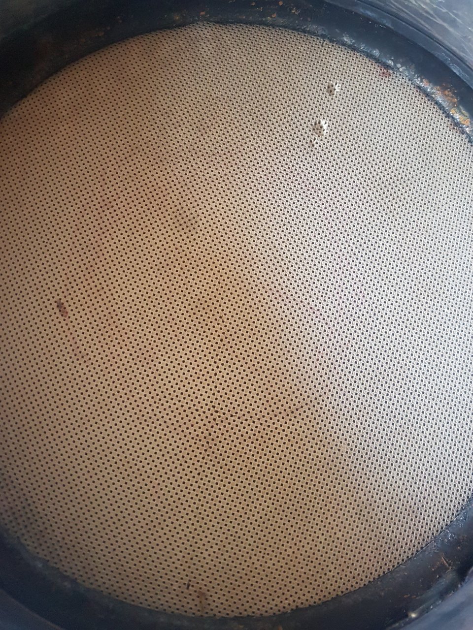

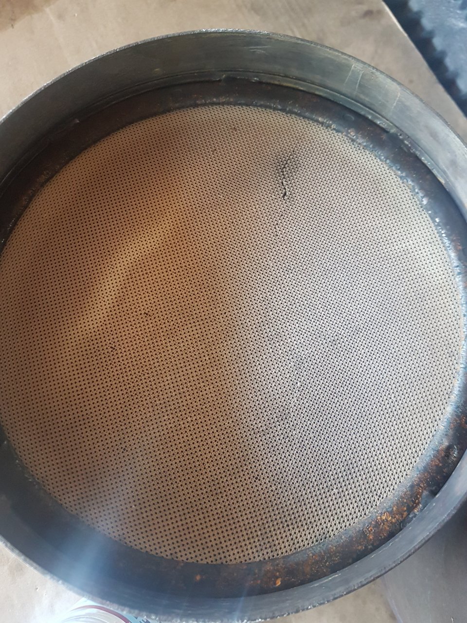

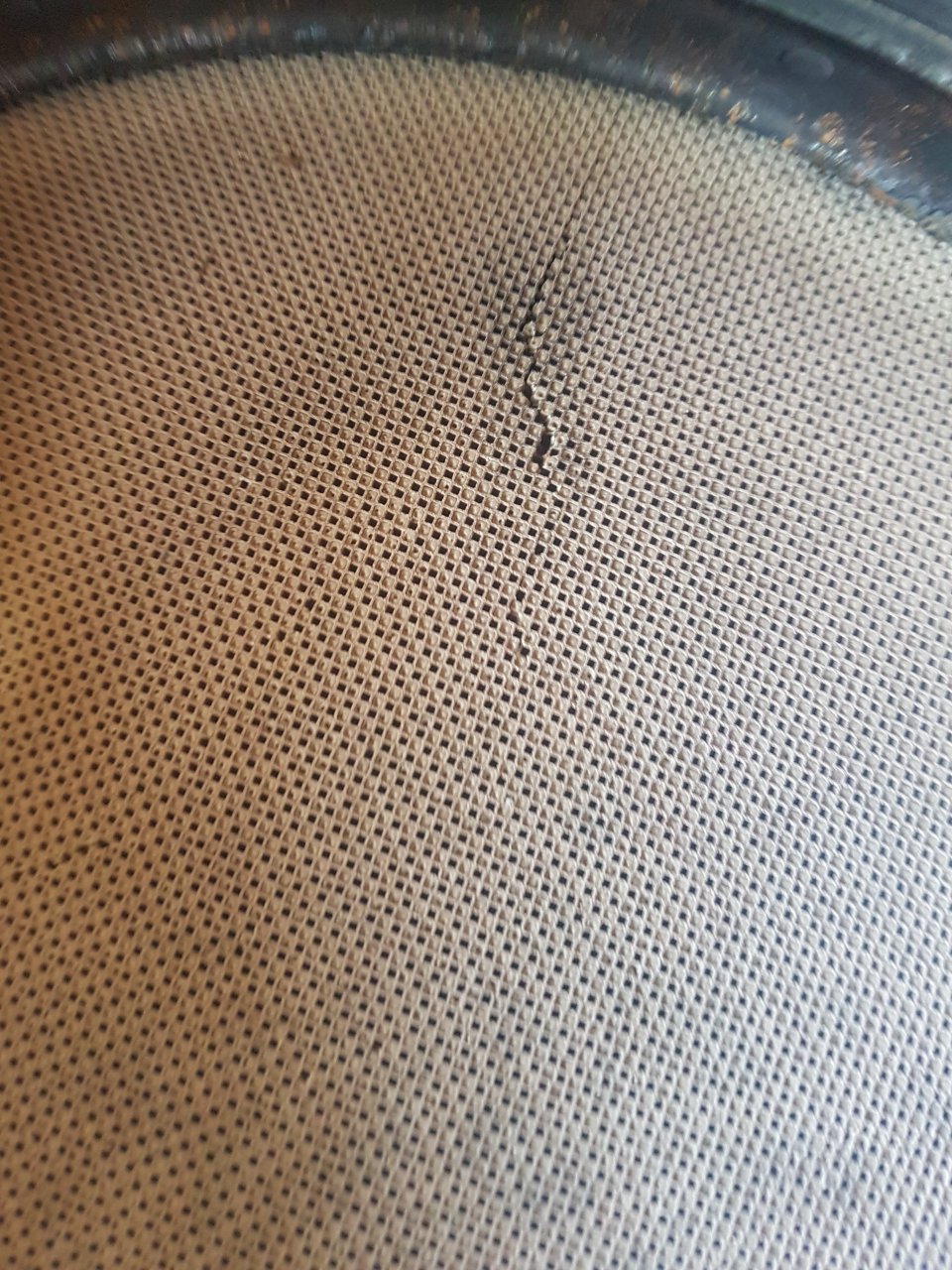

    I was doing dpf cleaning yesterday. Took of DPF's from EPA10 DD15. Cleaned it by hot water(45psi pressure). One of DPF's is cracked but owner will reuse it. He will have no problems. Soot is not passing beyond of DPFs.

    Hot water ? 45 psi ? Really? Must be hurting to not getting it cleaned correctly.

    I have done it more than 10x . Hot water perfectly cleans it. After cleaning I have checked them by rod to see how deep rod goes into dpf...
