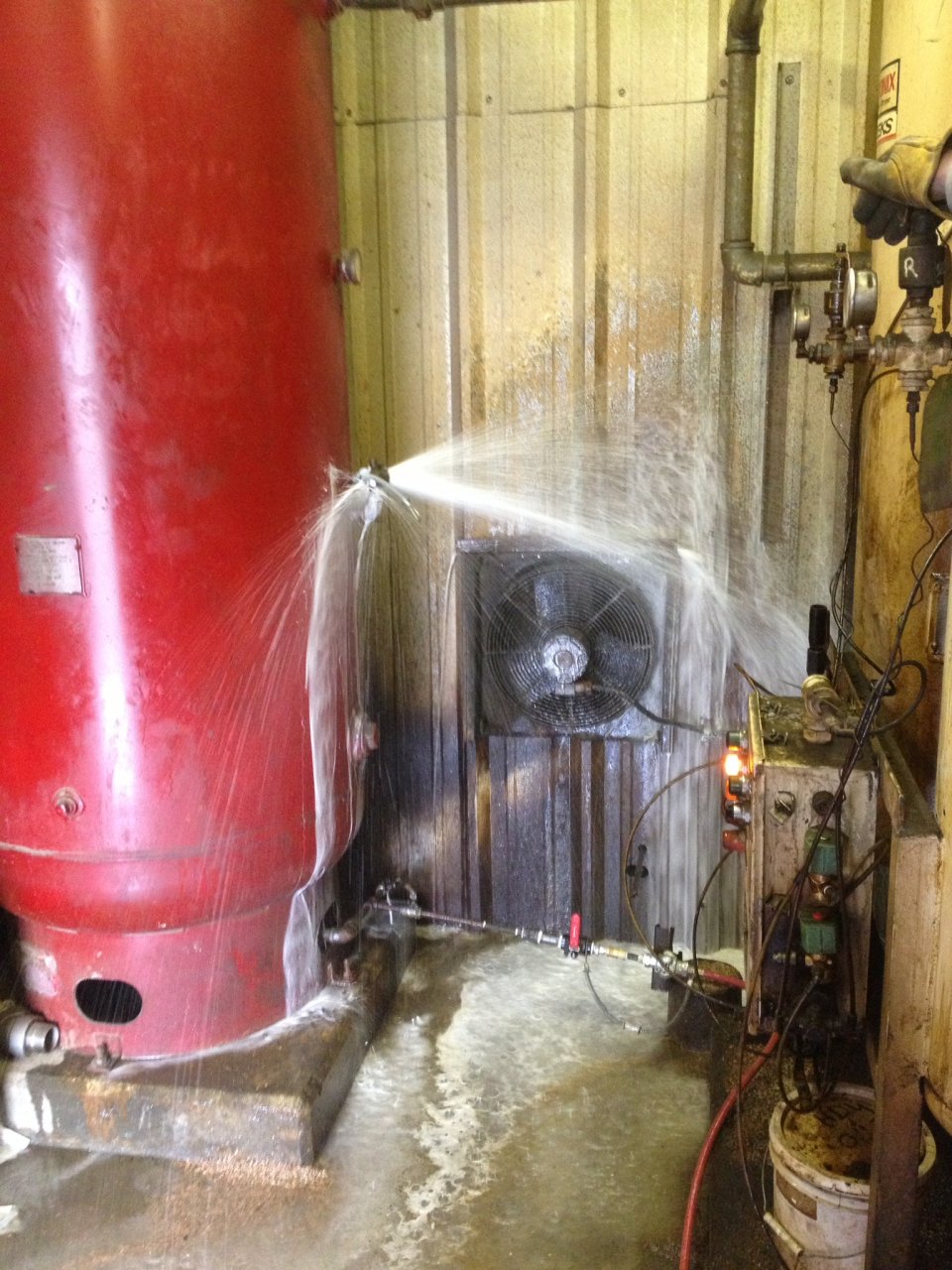

    Take a look at this as long as we are talking condensation. This is a mine where I worked some years back. They said the compressor wasn’t working very good. I went and popped the pressure valve to find this greatness.

    All I can see is that there is power to that panel on the right. Freaking me out.
