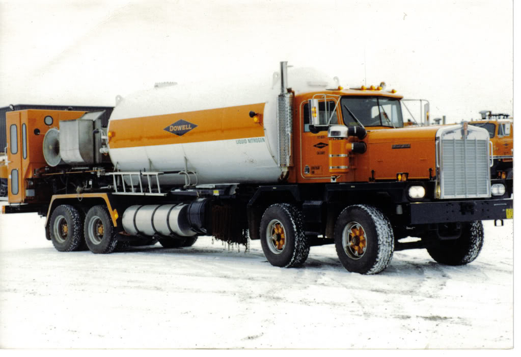

    Very common in the oil patch, concrete delivery, picker/crane trucks, etc. You will see twin steer bed trucks in the oil patch and crane trucks pulling a float or scissor neck (fixed fifth wheel), but as a matter of course they are not for semis--you couldn't load the steer axles enough to justify the cost and weight penalties.
    I used to operate this...

    Truck engine runs pump and hydraulics via A-box when stationary. It was a similar setup for twin cementers (two pumps, two 8v71/92s). Due to the increasing weight and complexity, all manufacturers went to trailer mounted equipment so the tractor is transportation only; therefore, twin steer not required.
    x1Heavy Thanks this.
