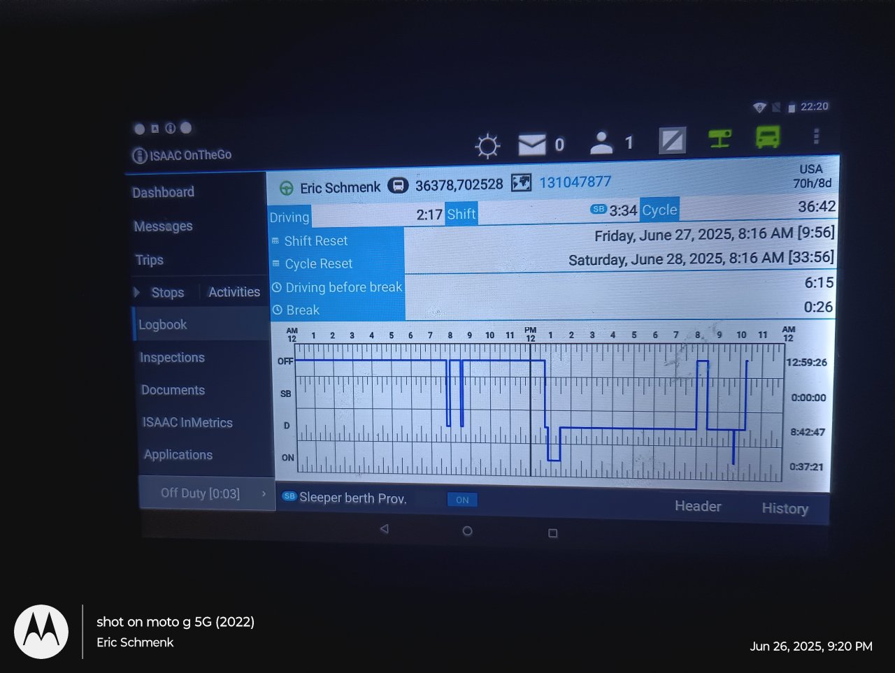

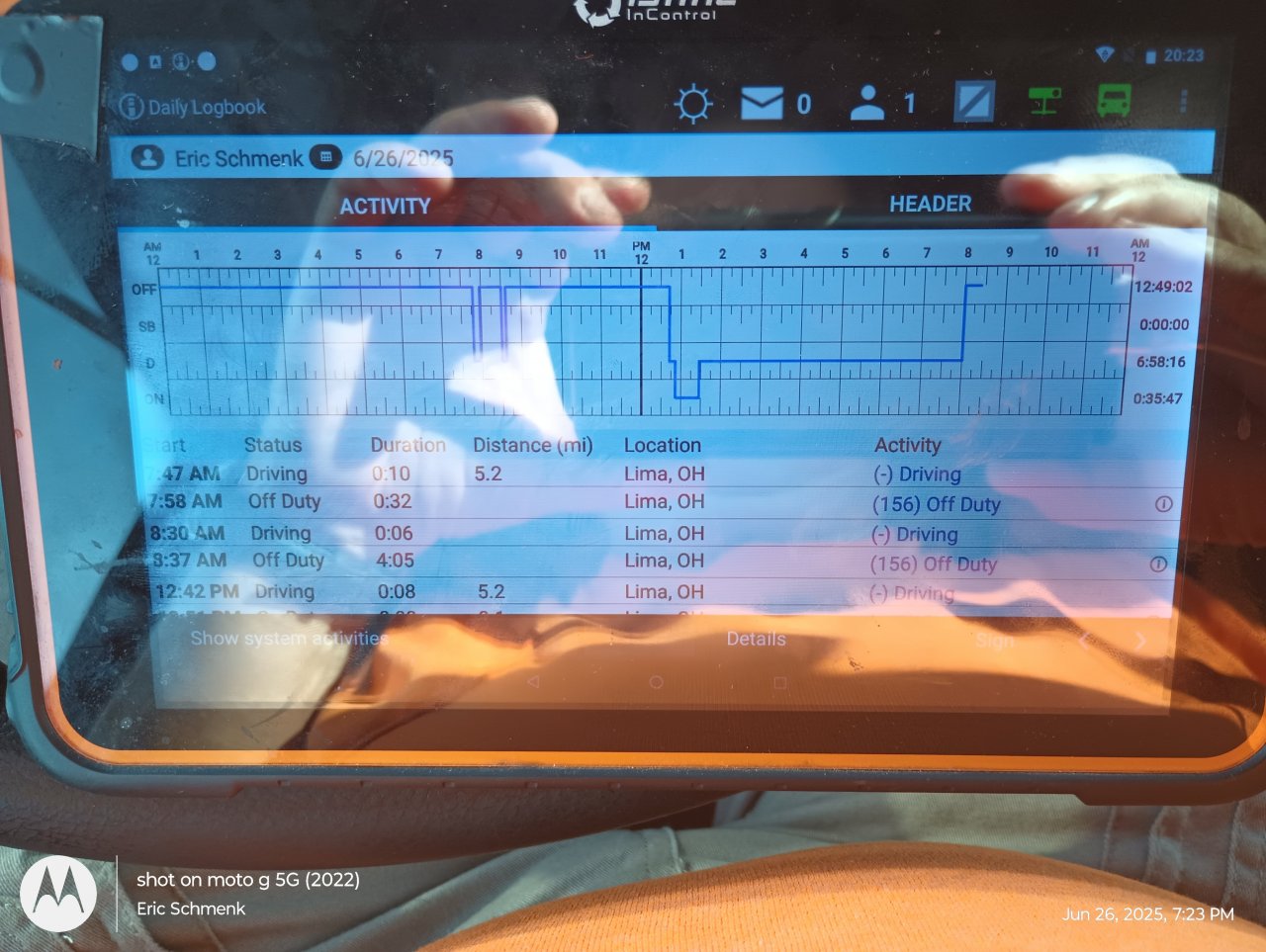

    Unfortunately, the company I am leased to forces me to use an ELD called ISAAC. It's horrible. The user interface is incredibly buggy. Of course, the FMCSA doesn't care about how difficult an ELD is to use, but they do care if you exceed your hours because it's calculating wrong. Here's a case where I think it's calculating hours of service wrong, but I want to make sure I am not the one making a mistake.
    On June 21, I first started driving at 0747 ET. At 2220 ET (1433 later) the ELD thinks I still have 3:34 left on my 14 hour clock. I was off duty for several hours in between, but never in the sleeper berth. I was driving at 2147 ET (exactly 14 hours after I started driving) without the ELD telling me that I needed to stop or flagging me for a HOS violation. Was this somehow legal? IMG_20250626_212000909.jpg IMG_20250626_192316998.jpg

    The shorter 2 to 3 hour period of being off duty does not have to be in the sleeper. The longer 7 to 8 hour period does have to be in the sleeper. So if you were off duty for at least 2 consecutive hours, your 14 hr clock was stopped. You ELD is probably right. You should study up of the split sleeper berth rule.

    You paused your 14 for 3 hours earlier in the day with your big off duty chunk of time.
