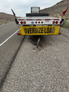

    Back in the 80s I ran heavy wrecker in the winter/spring when contstruction was slow. I had a call to pick a driver up in Wells and go south on 93 to set his truck up and tow it in.
    I picked up the driver and we headed to his truck. This was in the spring and snow had recently disappeared, but the gravel on the shoulder looked dry. The driver said that he just pulled over to take a leak, on a shoulder that looked just like where the OP ran over the delineater stake. As he was walking to the passenger side the right side of the tractor and trailer started settling and didn't stop until it was on it's side.
    So, don't trust a dry gravel surface in Northern Nevada in the spring time!

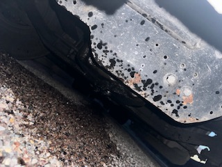

    What a cluster ##. Looks like he was pulling over to take a break out in the middle of nowhere and did not see that pole coming out of the ground. Seen a few of these before and they are hard to spot when not looking real close. That is why the oil is only a few feet long from draining. Must had been a pretty large hole. Bet something got sucked up like someone else had stated and that caused it to lock up. Might get lucky and not have to rebuild the whole #### thing. Keep us posted when you find out. Hate seeing stupid stuff like this break a man but it happens all the time.

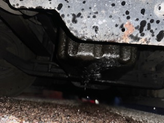

    if something was sucked up - most likely something was - there is this thing called an oil filter which would have stopped it because of the low oil pressure and low flow rate.
    I don't buy that this engine is frozen, I do think that there is a lot more to the story that isn't being disclosed.
    The amount of oil that dropped is irrelevant, but it could be an indication of the poor workmanship of any repair or an inframe.

  11. AFC
    AFC Heavy Load Member
    889
    1,177
    Jan 1, 2024
    You see the metal pole in the ground and you see the oil leaking all the way to the front of my truck. 75 ft. Please see pictures below.
