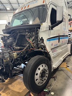

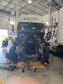

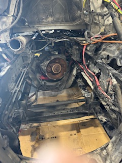

    Insurance is not going to do a total loss. The company is going to put a used engine from one of the other trucks in my truck. The engine will have 490k miles on it. They agreed to put the rebuilt cylinder head in my truck from the other truck. I will probably get some money for the roadside and tow truck after my $2500 deductible. Though this isn’t concrete yet. The insurance decision will be sometime next week. Attached are pictures of my truck.
