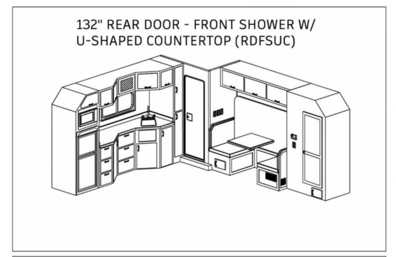

    I've thought a lot about extended sleepers and my biggest frustration is that it's not easy to just buy an empty box. I'd rather build mine out myself.
    None of the common companies will talk to you about this for liability reasons.
    -The best thing on powering the house is that you can get away from the unreliable and underperforming truck APU's. You have space with an extended sleeper for a proper diesel generator like the diesel pusher motorhomes have. Most extended sleepers are spec'd with these already I think.
    -As mentioned, for black water just spec a cassette toilet. Or better yet a composting type. No need for a black tank.
    A few things I would do differently than any I've seen so far on most of these:
    - I'd have a mini split for climate control in the house, with the addition of a big arse bunk heater to supplement it. All of the bunk heater manufacturers make bigger diesel bunk heaters for marine applications. They just aren't discussed for trucks because they aren't needed.
    -I'd also have the roof covered with solar panels. You have flat space on an extended sleeper to use better quality panels than all the surface mount/curved ones you see on trucks these days. The quality of the flexible panels is absolute junk compared to what you can get in a rigid panel. Without an inefficient rooftop RV air conditioner you have even more space for solar. About the only hole in roof would be for a 14x14 roof vent/fan. You can soak up some serious free power with the 8x12' (give or take) space a typical extended sleeper has. I would dedicate about a third of it to the chassis batteries and 2/3 to nursing the house bank along but of course it won't do nearly the job in a day that a diesel genny will in an hour or two of running.
    - Speaking of house battery banks, go lithium. So much lighter, longer lasting and the prices are coming down daily.
    -Run a coolant loop/heat exchanger for hot water. Limitless hot water this way.
    -Put an electric valve on your gray water tank and empty it rolling down the road.
    -I'd put a residential fridge/freezer in it if I were living on the road. A smallish one but still much bigger and better than any RV/truck fridge. Big motorhomes have been doing this for years. They last, contrary to popular belief. Stuff like this is why I'd want to build my own custom cabinets to match my appliances.
    Here's the floor plan I've had my eye on for years. I think I could build a palace on wheels with a 132" box and roughly this floor plan.

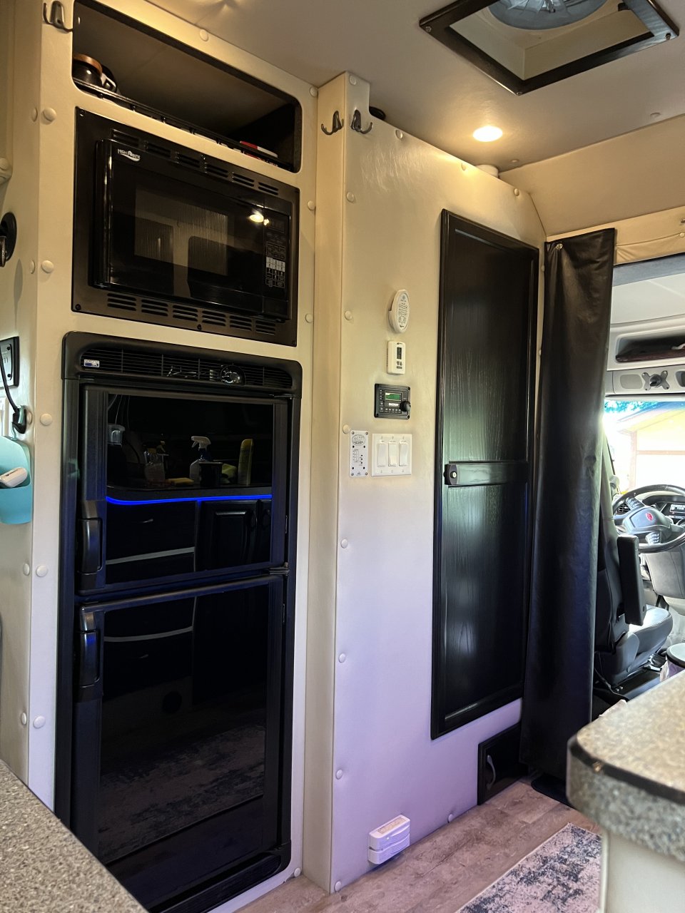

    First thing I did was tear out the factory refrigerator and put in a much better and larger. One works every bit as good as the one in the house.
    I also would have a bigger bed that would come down a track system from the ceiling of some sort and then when it was up to the ceiling below, it would be a sofa he’s not laid out very efficiently. They’re nice, but there’s so many better ideas you can do if you just think about it
    one picture is before and one is after I moved the microwave up and made a bigger hole
