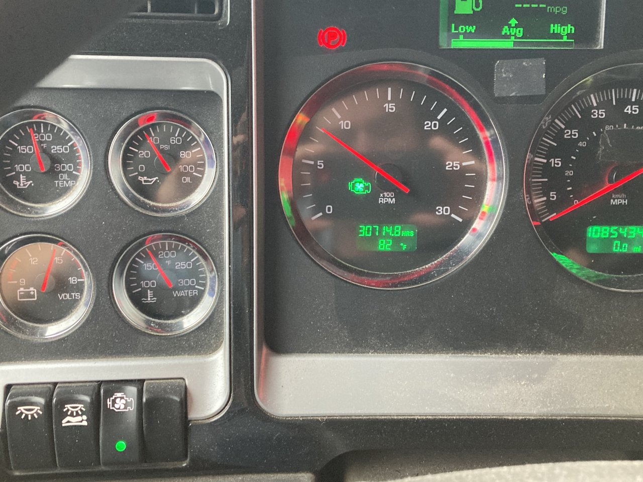

    Long time lurker here I'm in the market for my first truck and I was looking through some of the photos and noticed the engine is warm but the oil pressure looks awful low 2014 t660 mx13 455 motor has 190k on it truck 661k

    I don't know about mx.
    The isx I'm driving now also idles at 20. Runs at 40.

    That’s why you fast idle it.
    800 RPM has this ISX from 22ish to 35psi at idle.

    Paperwork on the engine rebuild or it didn't happen. Also order a Rig Dig report, get a dyno run, oil analysis on all the fluids and an ecm dump. Yes it cost some money but can save you from buying a turd

    mine jumps to 25 at 800.

    I think yours is sick.
