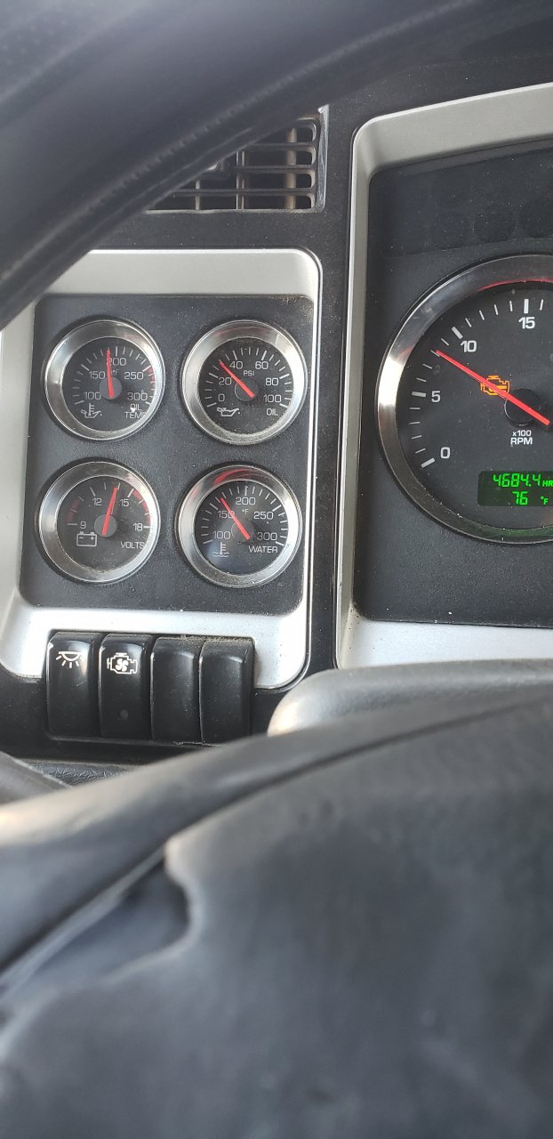

    Your temps aren't hot enough.
    I'll run the fan and see what it does.

    180 thermostat, but it’s now 74, and raining, been idle since 1400 Tuesday.

    31 at your temps. 33 at 180 oil degrees.

    Where is that oil temp reading from? And why is your coolant temp so much lower?
    Forgive my ignorance, my engine is yellow and old enough to drink for a few years now

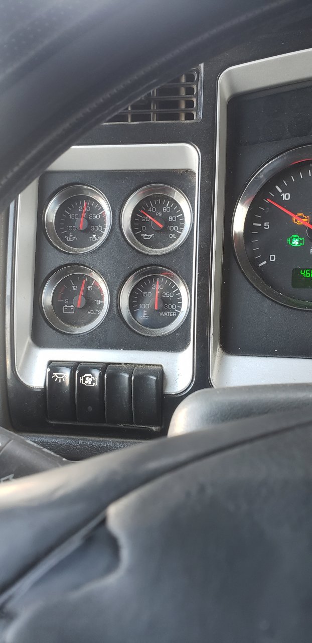

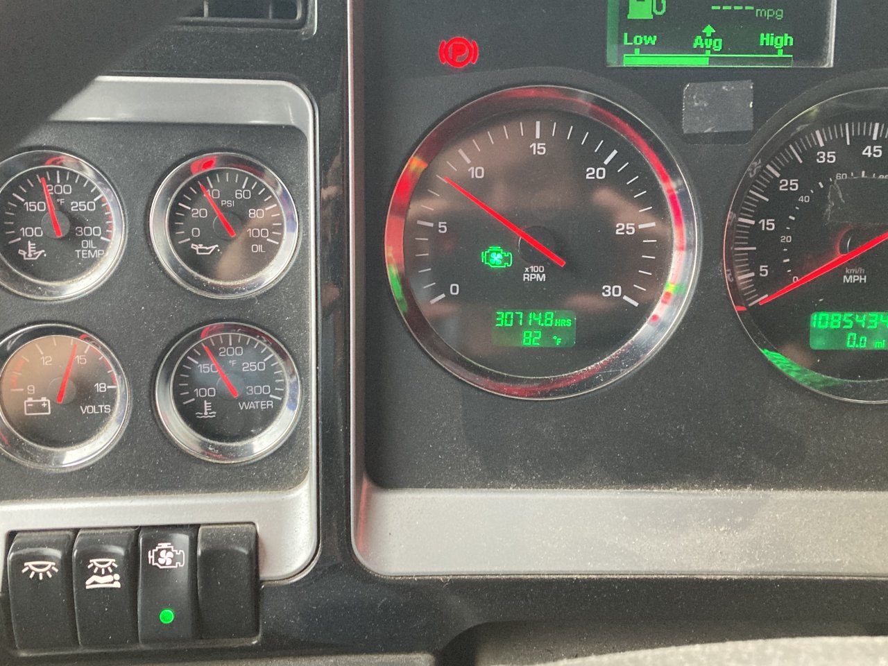

    Oil pressure is fine, mileage and CEL is more concerning. Edit, looking at wrong picture. What year MX?

    The one I posted about 2014

    It is fine at those RPM's, what is it @ 1500? Also most common thing I see for lower oil pressure on MX is wore out bearing in oil module for spinner filter or spinner cap bearing.
