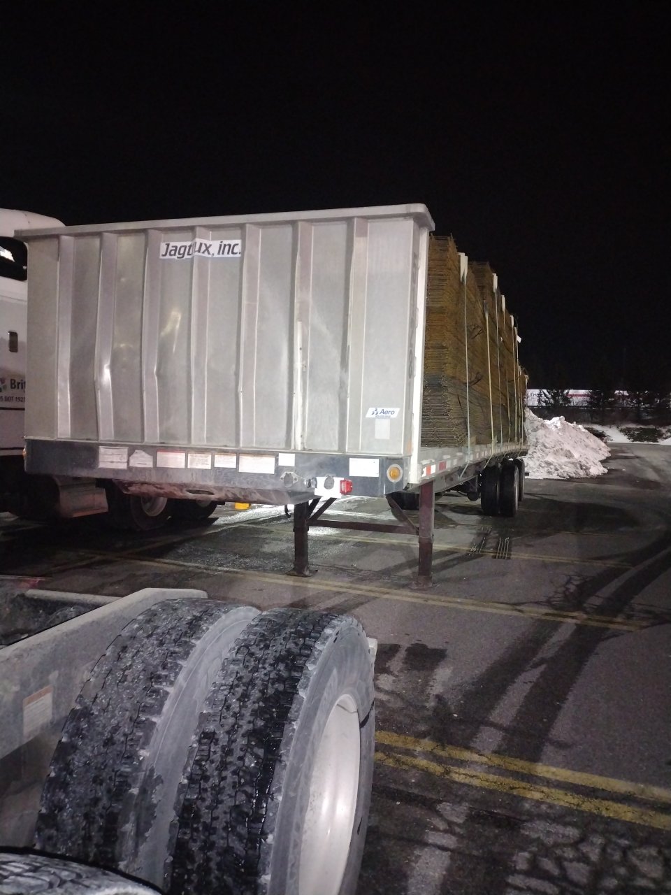

    So, I got loaded with wire mesh 8 ft by 8ft total full load. I have 7 stacks with 100 wire mesh in each stack. 3 and 3 stacks and top stack in the middle of both stacks. I was told by shipper the best way to strap these loads is 2 straps on the end ones and then 4 on the top stack.... But my load has shifted some and I'd like to get an idea of how to get it to shift back into normal place... Or is this somewhat normal the stack has shifted like a foot out of place. But has not moved much since. I have three hr drive to go still 200 miles. And not sure how I could get it to shift back without a fork lift. Any help guys or is this normal for this load. I have them strapped down tight and used v boards. Just want to be safe.

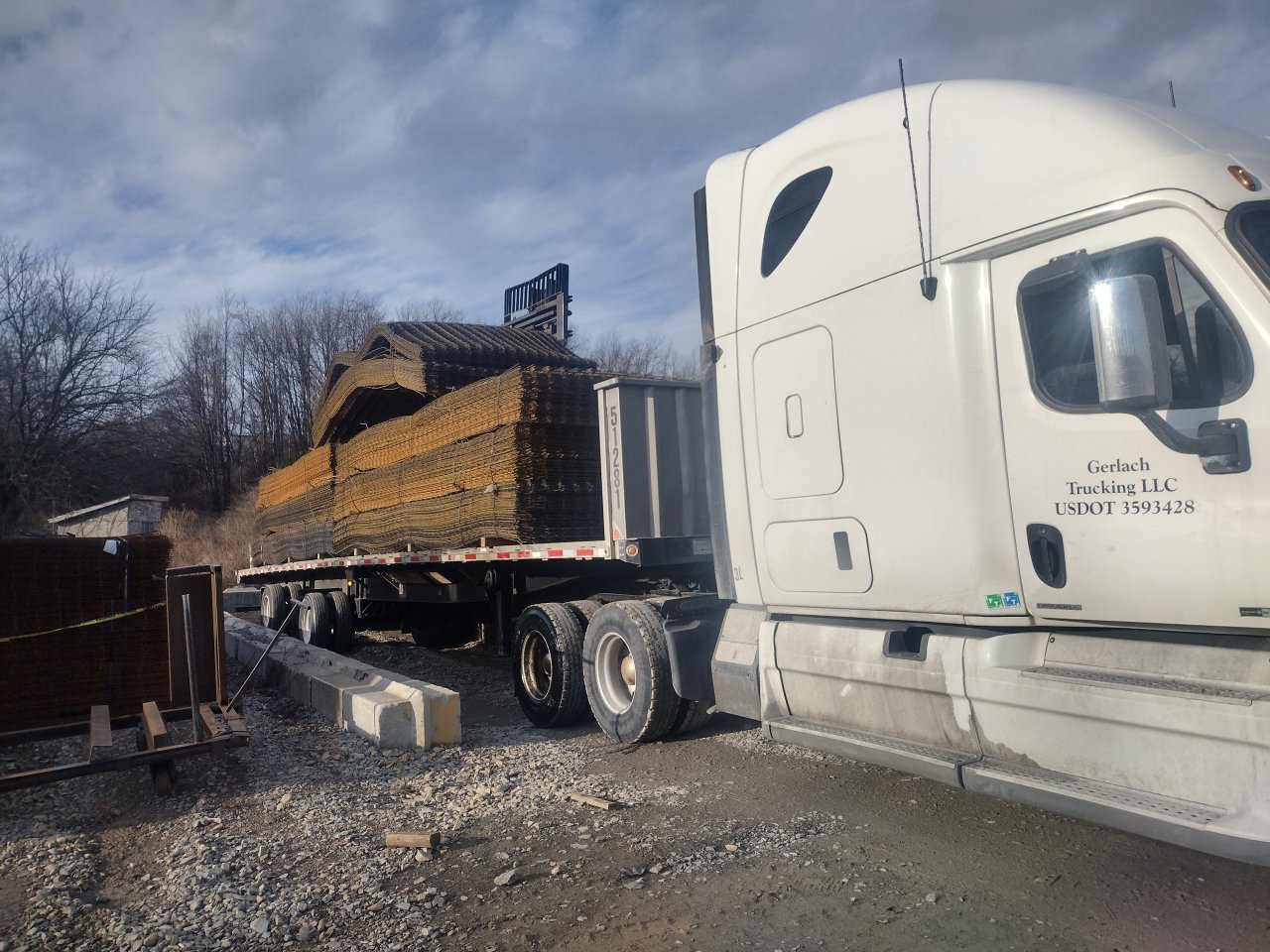

    I had a similar load once that did the exact same thing. I threw a couple cross chains on the ends. I wasn’t able to fix the shift, but this seemed to prevent it from getting any worse. Note this was several years ago, I just happened to still have the picture saved. Also, that trailer only had winches on one side, otherwise I would have done as others have suggested and tightened from both sides.

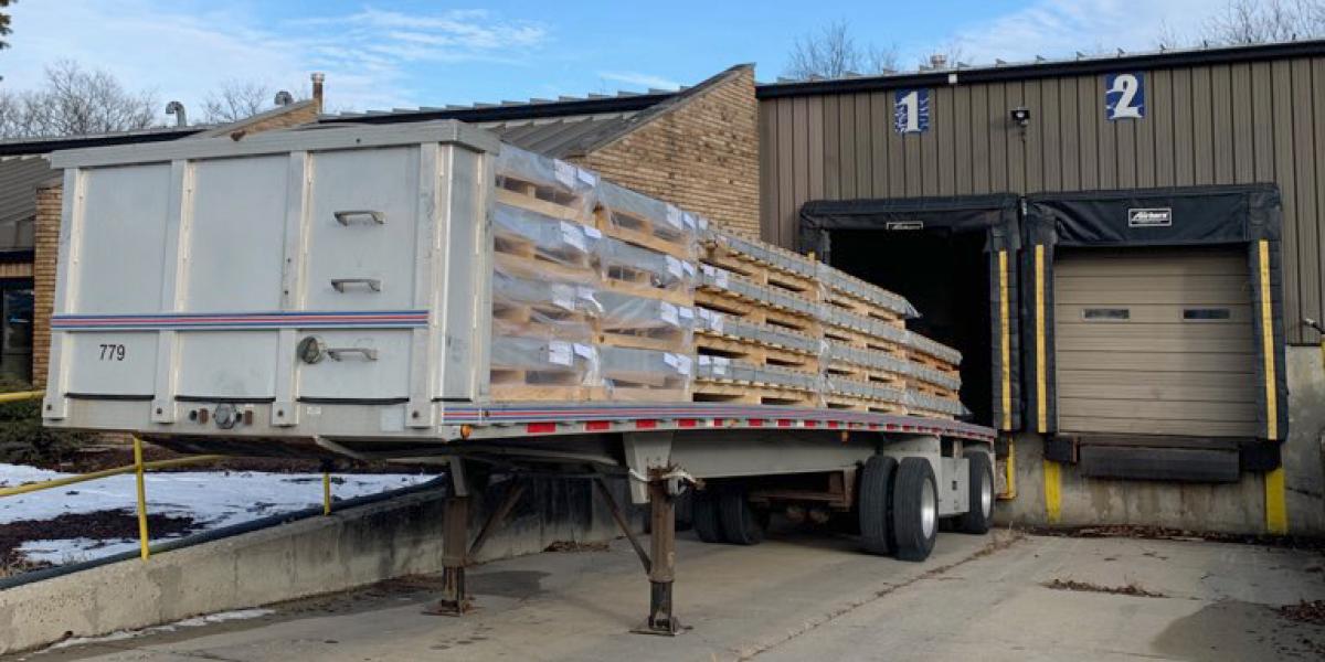

  8. Long FLD
    Long FLD Road Train Member
    13,019
    54,648
    Mar 4, 2015
    Kind of the same but different. This is how I’d do it when we would haul this stuff out of Calgary.

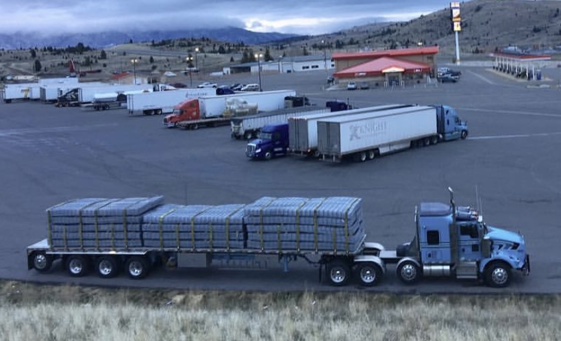

  9. Espressolane
    18,856
    118,493
    That is about how we do that. Only difference is I like to put a piece of wood on the top in the middle of the stack. Helps with squeezing the load down.

    I would cross straps but only one side has wrenches and it's a rental trailer. I will post pics and I'm going to be careful and also try some more wrenches as it's on the same side as the wrenches. Night pic is how far it shifted on passenger side and its enough to I just moved mirror on passenger side so I could see. I'll show better pic tomorrow
