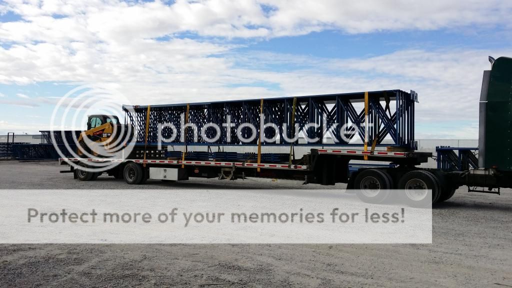

    I do have a pic of some 40 - 48ft caissons I hauled a while back. This load could not be done on a regular flat due to the excessive height needed. 13'3 on my deck.
    I enjoy showing this pic because it shows excellent utilization of deck space and load leveler usage in order to make 2 loads work together.
