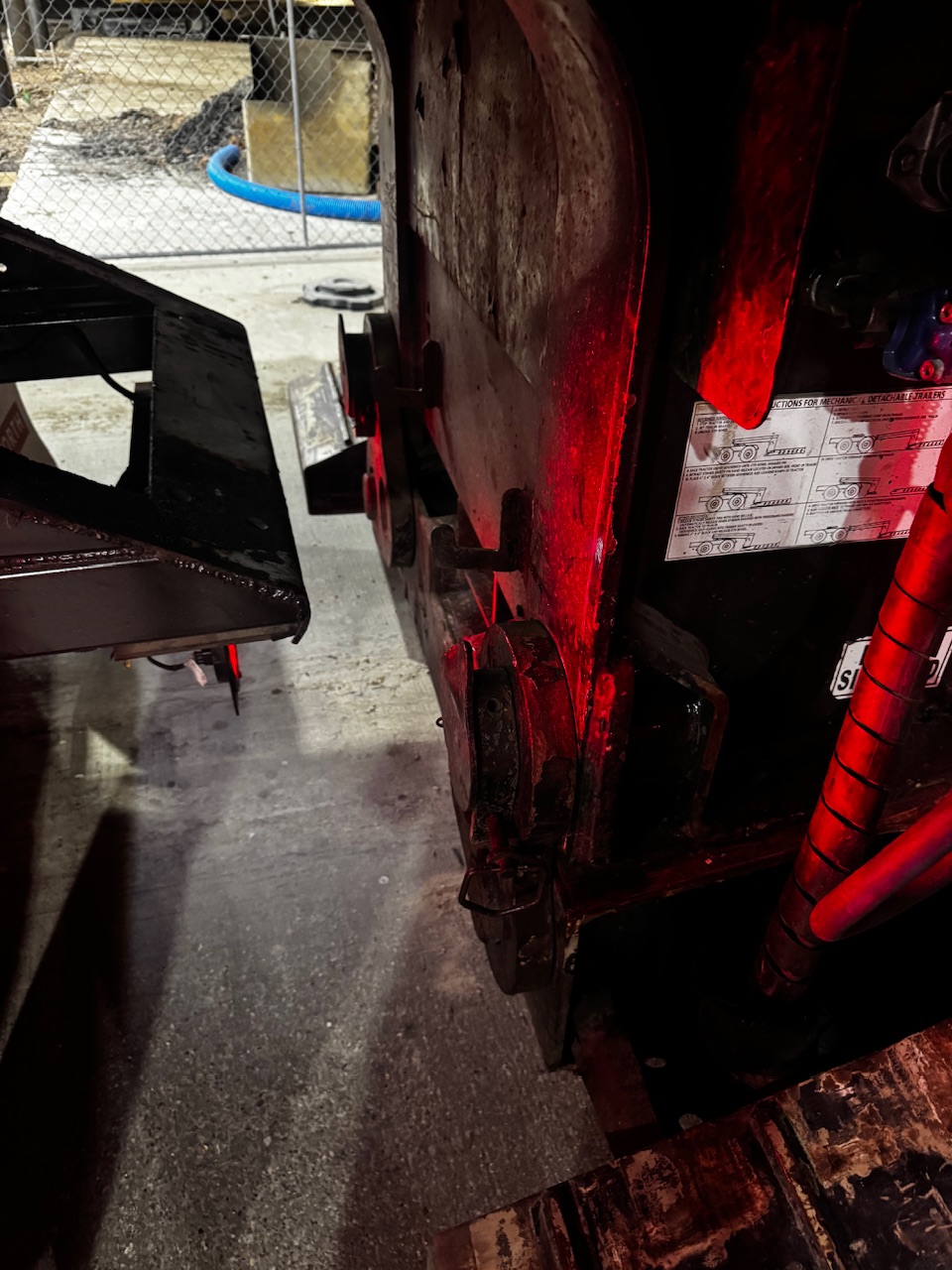

    Update: I was able to move the fifth wheel stopper 10 inches. I could not afford redoing the ramps. They wanted about $2k. This was not my company’s mechanics but a decent shop in Texas during my hometime. I will upload picture later today when I get to my truck.

    I am hoping that this will be enough to transfer weight to my steers. I will also make sure the pusher lift axle has under 50 psi air in it as well.

    Cut that frame off right behind the mudflaps. Put a radius on the end of the frame rails and be done.
    As long as you keep the rollers greased up,you'll still be able to get under it.

    Will do when I have my finances in better shape. Looks much better than where I had it. Will see how much of a transfer of weight this does.
