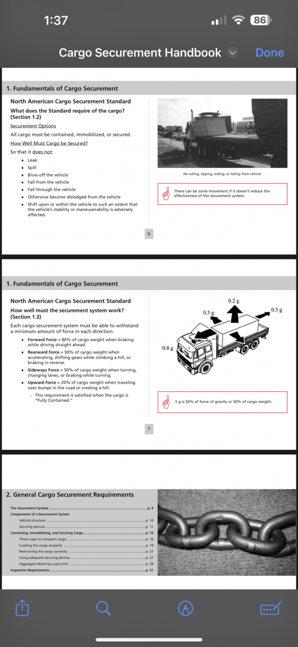

    So I see it says forward force is 80% of load weight. But how do you achieve that? Does that mean you need wll of 80% of load? Thank you ahead of time.

    Your rear pull. For those brake check moments. Mainly this will apply to heavy equipment. The regs say that you have to have 4 points of securement for heavy equipment (10k or heavier) regardless of the WLL of your securement. Your securement is to prevent the load from going forward(80%WLL), back(50%), side to side(50%) and up and down (50%). For heavy equipment, you will do 4 points DIRECT. So take your machine and multiply by 0.8 and your securement to the rear has to be enough to cover.
    Hope I made sense.
