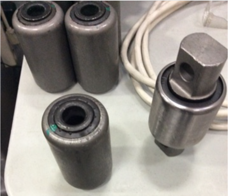

    20201102_162527.jpg Hey could this be a sign on bushing failure or just normal rubber wear?
    bzinger Thanks this.
  3. Judge
    13,972
    93,000
    Bushing is wore out.

    What you think about this one? 20201102_161748.jpg Its on my rear axle
    jamespmack Thanks this.
  6. AModelCat
    29,744
    165,215
    That one's getting a little pounded out. Gotta love the Airliner. Those bushings never last. On the plus side they're relatively quick and easy to replace.

    They improved the bushing corrosion resistance. What happens is that the inside of the bushing gets rusted out and it starts wearing out that way through the clearance enlarging. Then it loosens and goes to crap.
    The updated ones should have a green dot on them I think.
