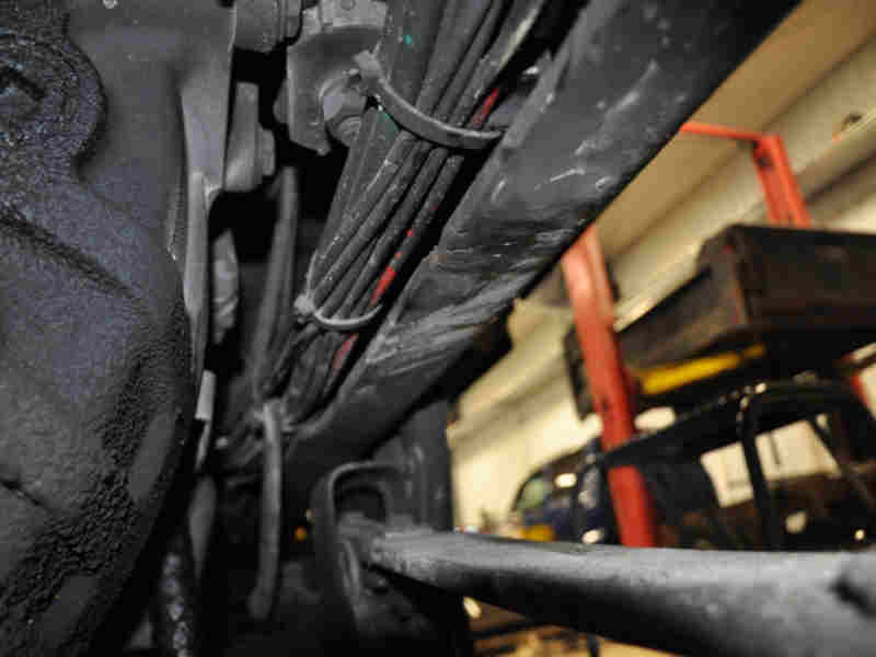

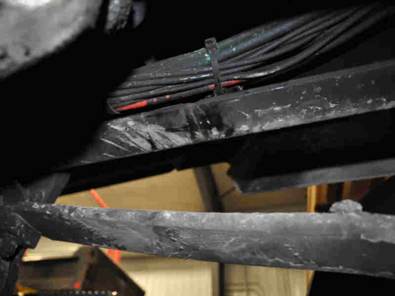

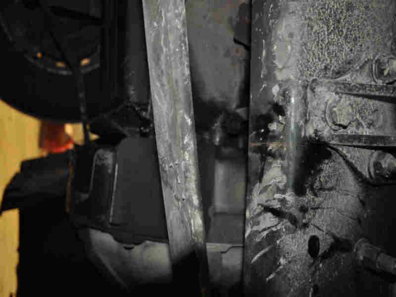

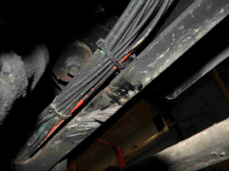

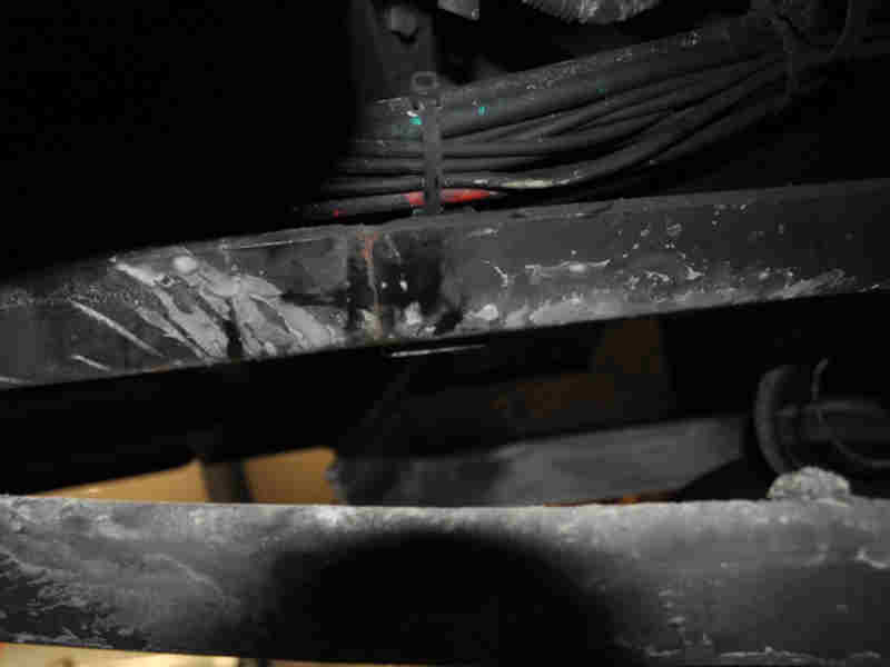

    I think the pictures speak for themselves.

    Failure at that location would have resulted in complete loss of control of the vehicle. It is directly behind the left cab mount, in front of the steering left rear spring mount.

    That is very unfortunate. I thought a couple of the pics looked like the crack had been repaired by welding then grinding it down flush and painting.

    Do we know what bent the frame , one picture clearly shows a bend. Looks like it may have been in major accident ?

    there is no bend, there is no weld.
    There is a thin dishing in the flange the crack is in the very middle of.

    Yep, right at the crack the rail has been ground down or something, not a straight edge. That sucks man, sorry to hear that.

    Yeah, I would be surprised if you hadn't gone over it with a fine toothed comb - but that crack does not look new.
    If it's found to have been repaired at some point, perhaps you have some recourse against PPP, as I believe that part of the DOT inspection is checking the frame for unauthorized welds on the flanges.
    As for the bend, if you look at the picture where you've done a long shot to the rear along the rail, you can see it on the horizontal flange part of the rail just above the spring hanger behind the bellhousing.

    That's in the paint, Not in the metal.

    looks like stress twist on terraim.
    I saw the same with Volvo FH used with tankers on terrain near Lugansk. Ukraine. Why - aswer is easy - twist! front drive goes up running over bump, rear - down to hole for example
    First I see is the rust, it says that crack is relativelly old and there are some cracks around, so frame must be fixed. it is not so difficult and expencive as looks, but you have to find good workshop with good welding mashines. The only way to make this truck safe - use enforsing inserts welded in frame.
