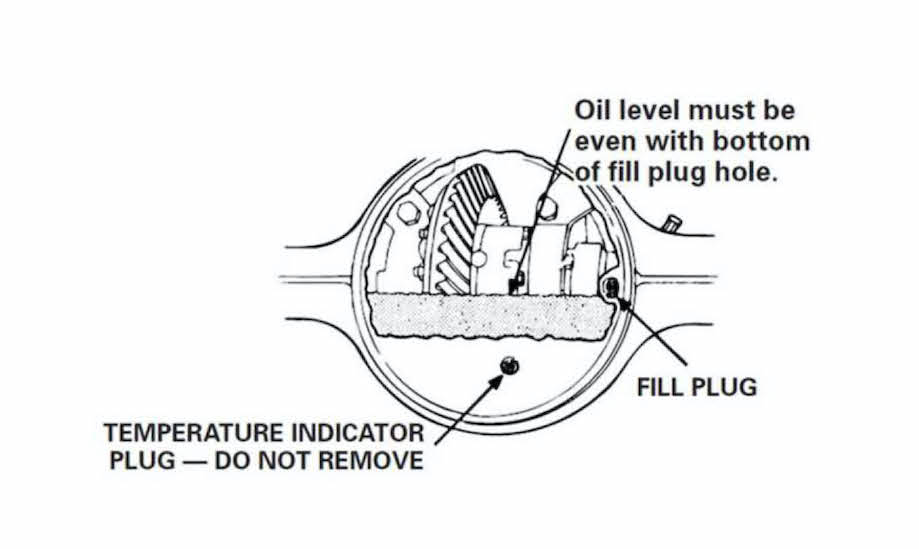

    You do not fill a differential from the wheel ends, on the back of your "pumpkin" (the big roundish thing that actually houses your differential) there should be a plug on the bottom (for draining oil) and a plug off center roughly 1/3 to 1/2 up from the bottom, see pic.
