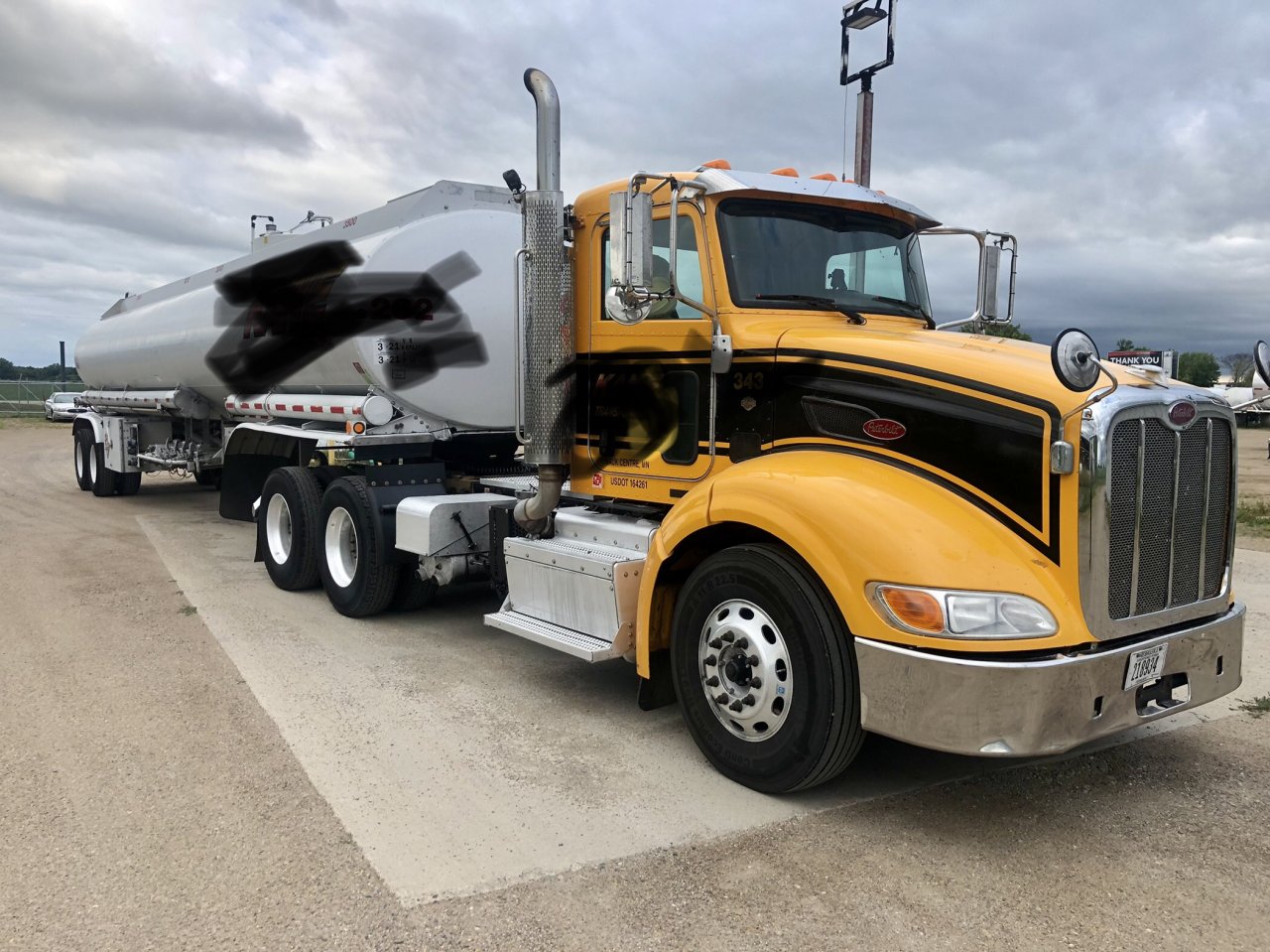

    6954B50A-9ACF-41FC-9F3C-DEAF4A9A839F.jpeg This truck and trailer I’m 27800 to 28200 depending on fuel. That tanker has four pockets and a 9500 gallon capacity. The most I ever load this time of year is gross 9200 gallons of denaturant (Natural Gasoline). The net gallons was 9450 and product temp was 27.0. Is called at 79980 .

    Where do you get natgas that's only 27°F?
    We haul some that's usually in the 80s, depending on ambient temperature.

    Natural gas drippings not natural gas. It’s called natural gasoline. I think it’s NG5 if I remember correctly

    Yes, natural gasoline, C5, that's what I was asking about.

    Minnesota. Comes out of a pipeline.
