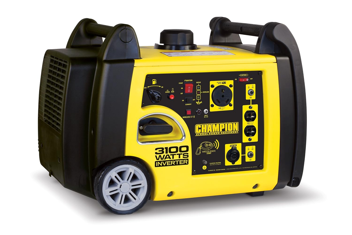

    I ended up going with this generator
    http://www.amazon.com/Champion-Powe...&redirect=true&ref_=oh_aui_detailpage_o00_s00
    http://www.ebay.com/itm/DURAMAX-Flo...927421?hash=item5b24d4757d:g:eecAAOxyg7xSZ-u4
    Remote wireless start, eco mode and runs 70 hours on 14 gallon fuel caddy with 6k btu AC.
    http://www.sylvane.com/friedrich-cp06g10-window-air-conditioner.html mounted in top bunk area through back wall. It is a chassis unit so was easier to mount, and it was setup for either wall or window mount. I tried a 8k portable single hose unit and I just wasn't impressed so took it back and got the wall unit. I mounted it like skateboard and it takes up less cabin area.
    I do not use 1.6 gallon fuel tank that is on the unit, I plumbed the 14 gallon fuel caddy through 1/4 fuel line into the factory fuel cut off switch with quick disconnect in the line from caddy. When I need fuel, I unstrap it from the catwalk and roll fuel caddy over to the gasoline side and fill it up.
    Generator 850
    Fuel Caddy 120
    6000 BTU AC 300
    1270.00 Generator is very quiet. Generator and the AC have 2 yr warranties.
