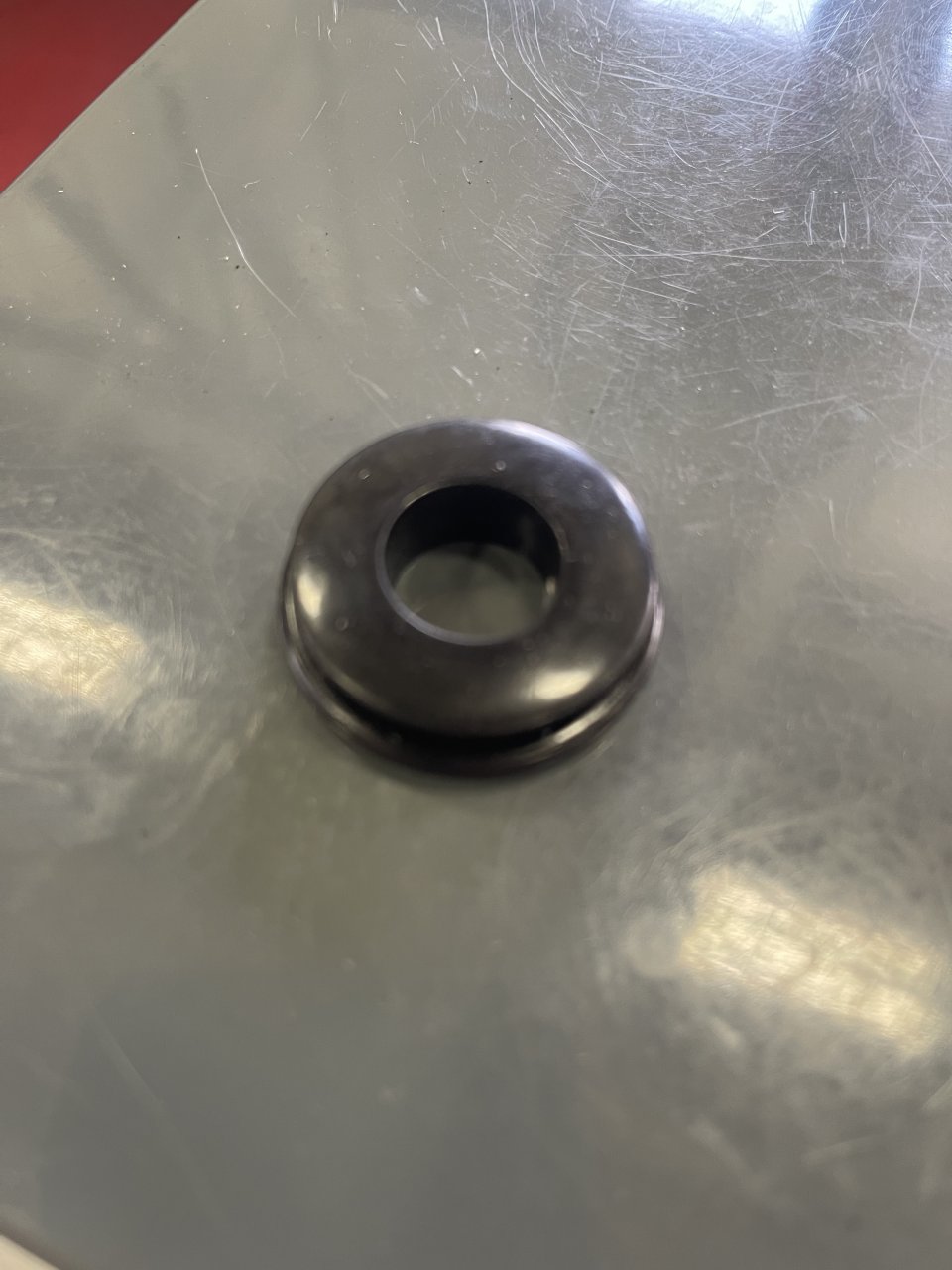

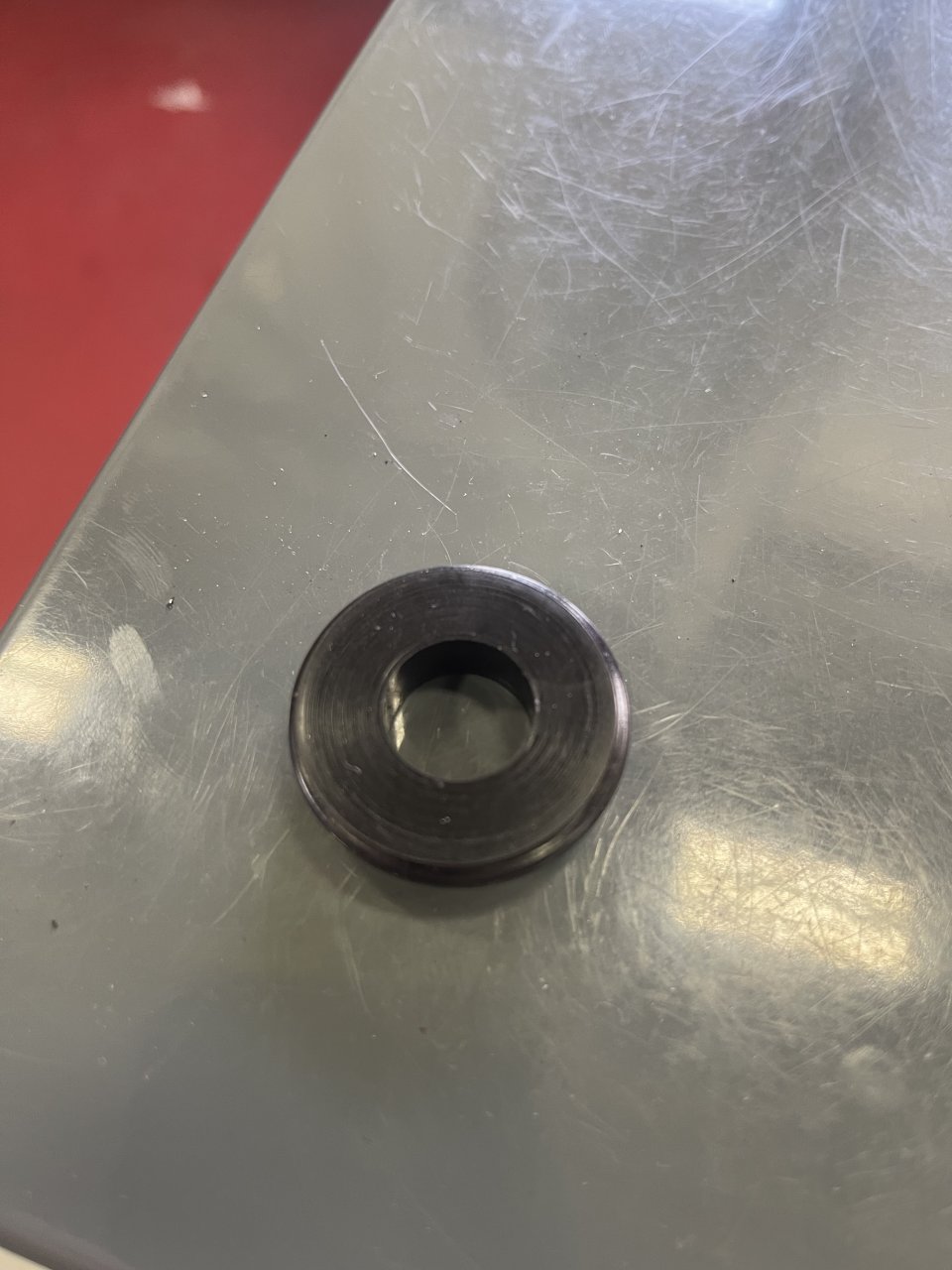

    There are teflon gladhand seals where the big diameter goes into the gladhand. They don’t function well at all when installed backwards. Impossible to connect as well when they are on both sides. IMG_3784.jpeg IMG_3783.jpeg
    The Teflon does not crack with age like the rubber ones.
