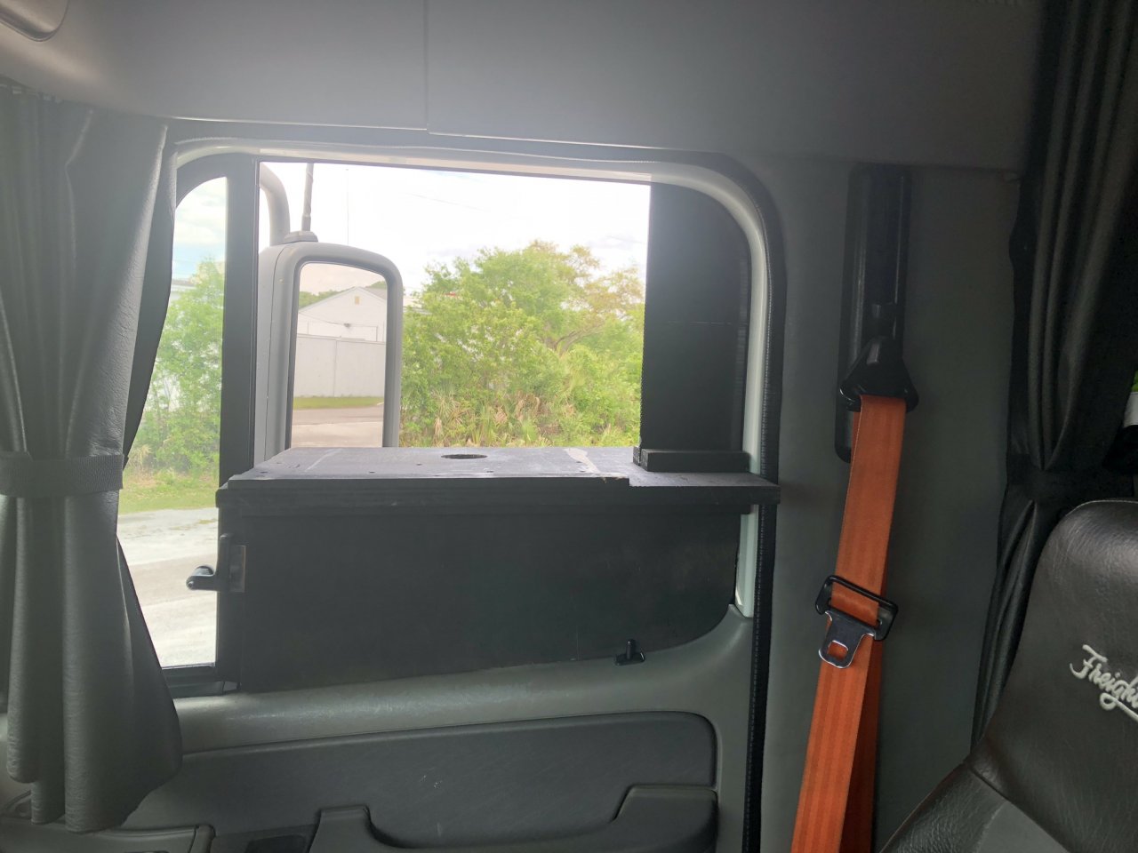

    So you place that shelf and window ac unit every night?

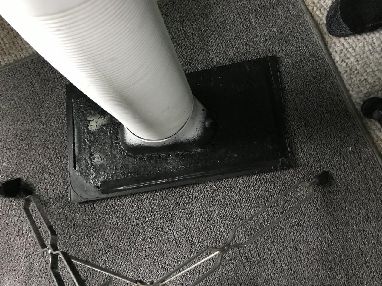

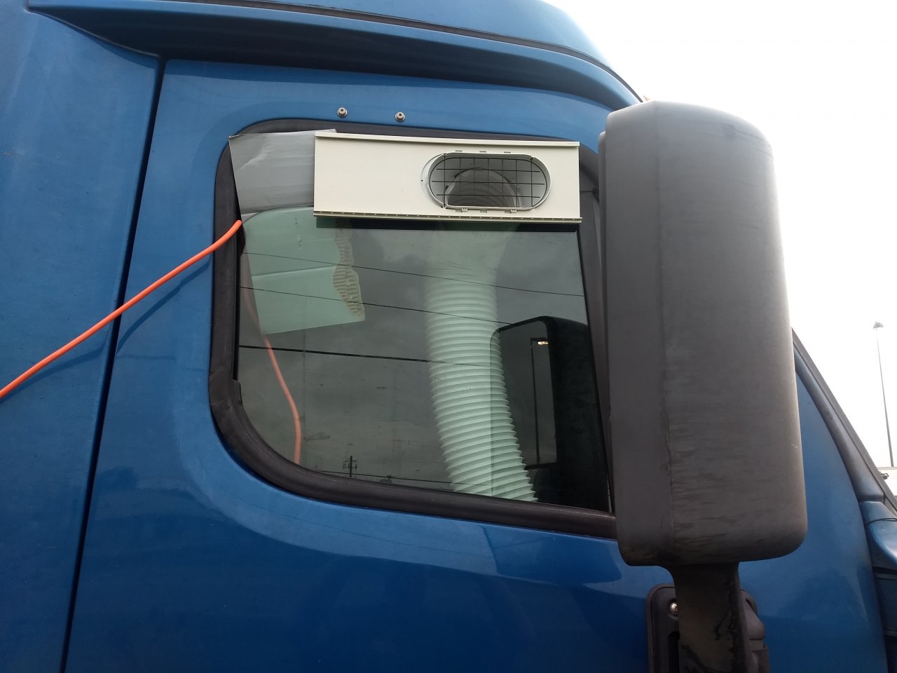

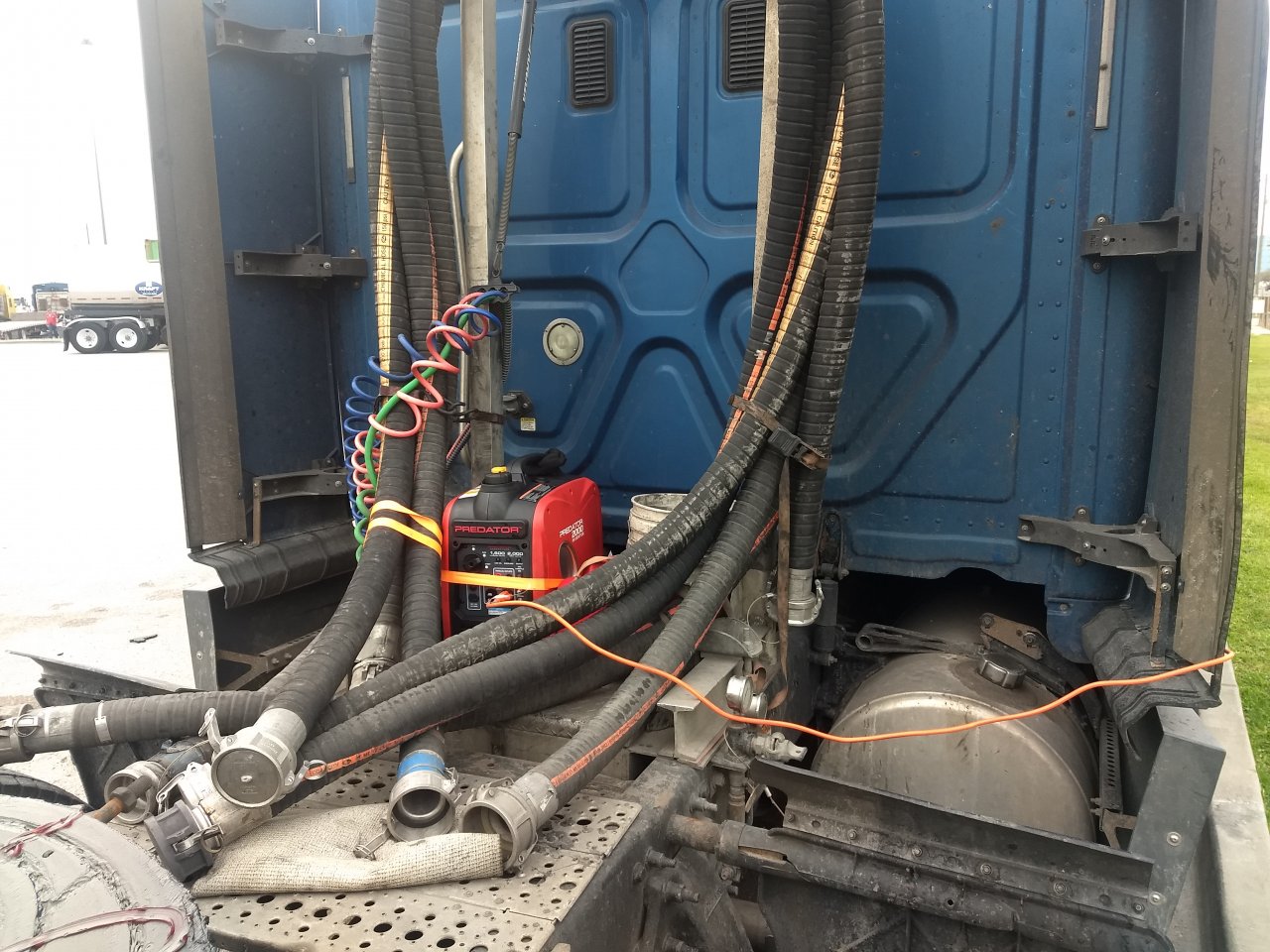

    You can tidy up your outlet using a breezeway screen with some aluminum flashing cut to fit, zip ties and some flex seal spray.
    B01D2EF8-1B2D-48A7-9CA5-3784F533E5FD.jpeg 353D208C-F07E-466C-A17C-A6D496CE281A.jpeg

  5. Rideandrepair
    17,626
    57,041
    Aug 8, 2015

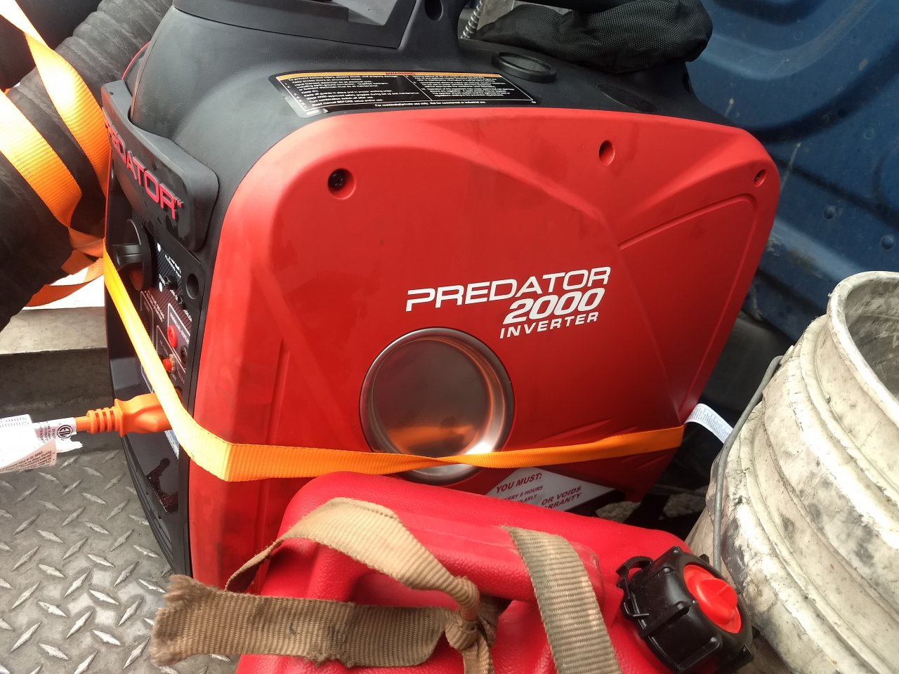

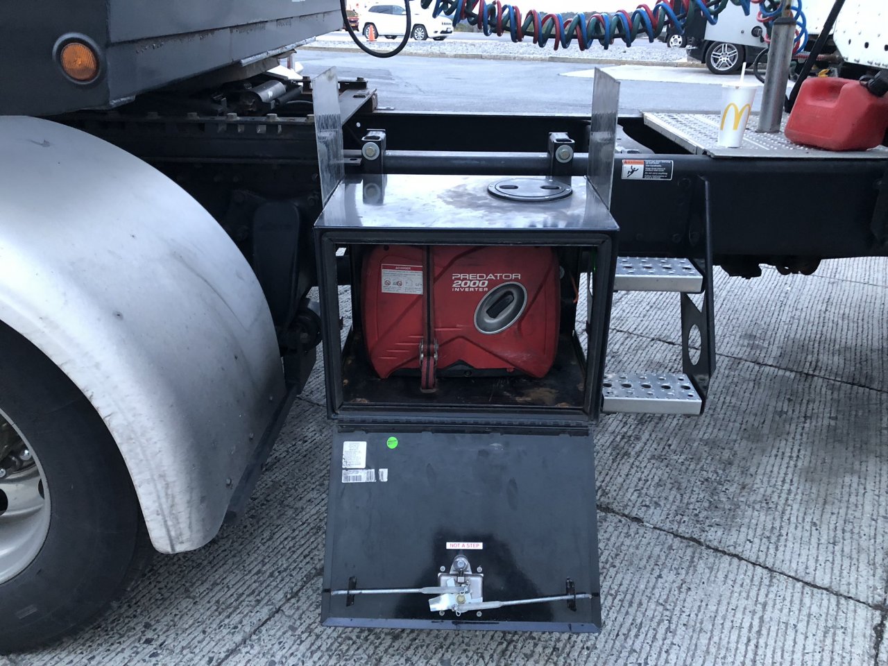

    That’s an outboard motor tank with a fancy stainless steel cap for the generator. Keeps system sealed so no need for an extra fuel pump, still vented also. It would not be hard or expensive to make a similar one for 25% of that price.
    win-some-loose-less and 77fib77 Thank this.

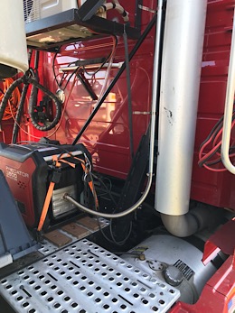

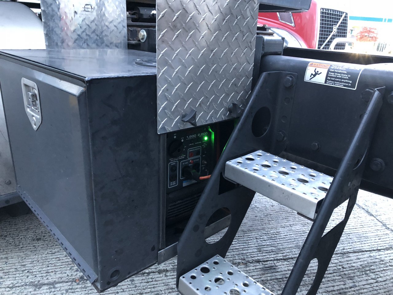

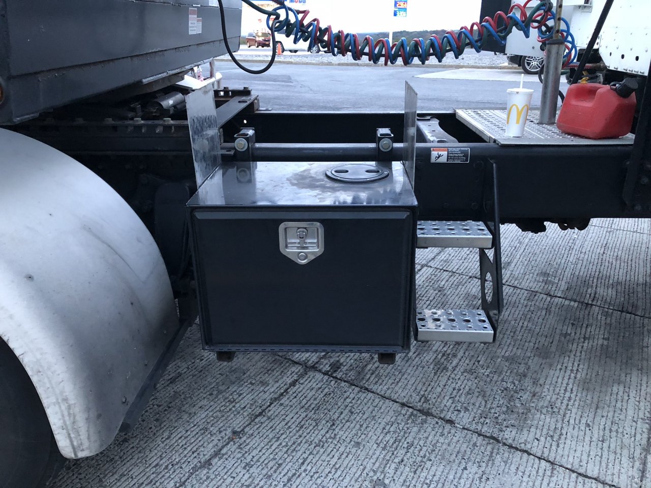

    Here's the problem with me doing a cleaner install. 228 inch wheel base.
    Rideandrepair Thanks this.

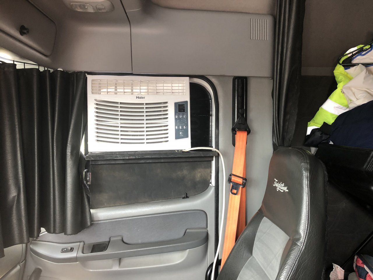

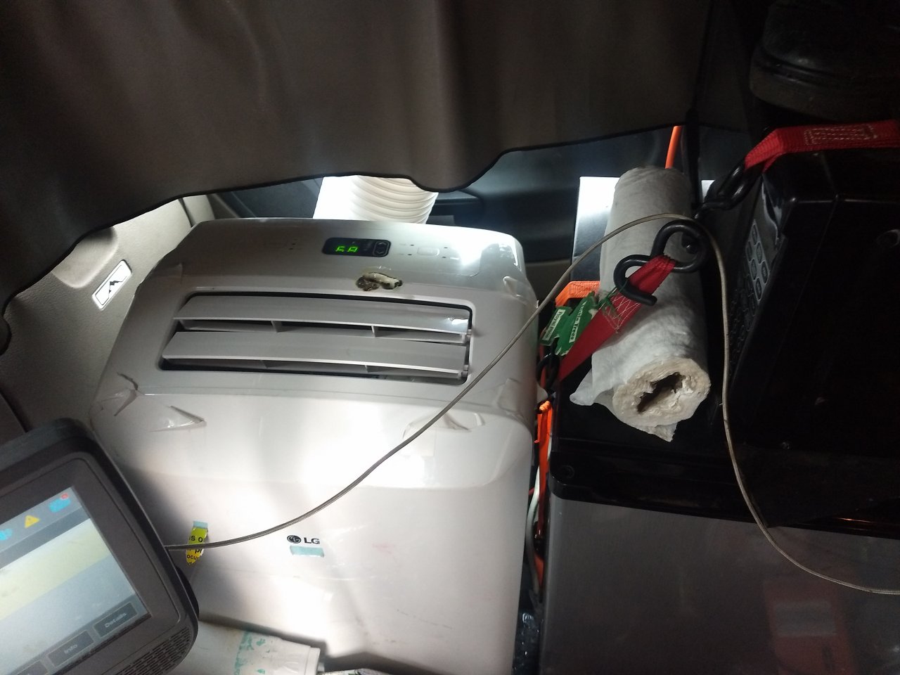

    I used it last night. Most of the time the AC was off and the generator just idled. It ran out of fuel sometime in the early morning. I Had it running since 7pm, at 7 pm thr AC ran the whole time and the gen was running middle hard.
    I bought a 7" fan to push the cold air into the sleeper.
    Tug Toy and Rideandrepair Thank this.

    Put an exhaust pipe on it or you're going to gas yourself and your neighbors. Trust me.

    Those A/C units are probably like microwaves in that they require a much higher voltage just for the initial startup. I have an 1800w inverter, and I remember years ago trying to run a microwave with about 1200w, and it wouldn’t power up. Even when I got it to run, it eventually turned off. I use a 700w microwave in my truck.

    My unit leaked water everywhere. Even though it was supposed to be a self evaporating system. It uses a sprayer to mist water onto the coil. High humidity it was useless. Also needs to be kept level. It gets full and shuts off. I used it while running down the road. Had to occasionally tilt it, spilling water out of the full bucket to get it to restart.It was a mess but better than nothing. Lol. I never really figured out proper drain set up. There’s 2 hoses 1 crimped. Hopefully yours will work well for you, or maybe set it up to drain if needed.

    There’s a thread on here called rooftop ac or apu? One example has a mini split unit for $800. 12000 btu which is overkill but same as most apus have. It’s basically a small residential central air unit. Nice set up.Id like to find a smaller one, So I can save as much fuel as possible with generator. That little 2000 is economical, I tried to run a 10000btu portable but had to return it and get the 8000 btu.
