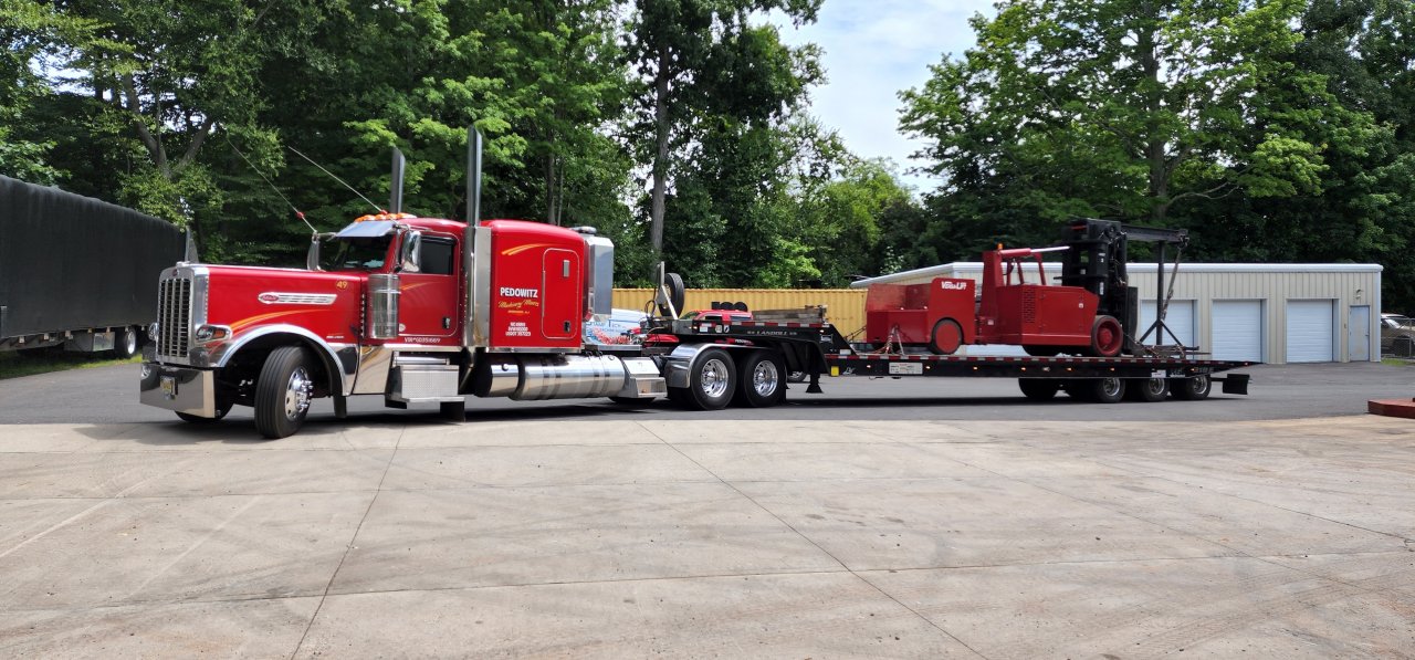

    I am a mechanic at a small construction/rigging company in Ohio. I've been tasked with finding a trailer to haul a 40/60 Versa-Lift my company will be purchasing. Now, I have my CDL and I have hauled machinery and ran heavy wreckers, but never had to deal with worrying about axle weights and the such. So, to provide a little background, the forklift will weigh 58,000 completely assembled. The counterweights, forks, and boom can be removed and placed on another trailer, but my company wants to haul it complete. I have been told that we need a 3-axle trailer, but I am still lost on if our 3-axle tractors will be sufficient. What do I need to be looking at when it comes to knowing how many axles I need, the correct spacing, if this load will have to be permitted each time, etc? Any info about this, pertaining to Ohio law, is greatly appreciated since all I really am is a grease monkey, not a trucker!

    Look at a Landoll 455. They are a 3 axle tilt deck trailer. That's what almost every rigging company I've seen use for their large forklifts / versa lifts. They have axles that slide forward and let the deck tilt down at a very low angle that a Versalift can easily drive right onto.
    3 axle tractor should be fine to pull it. You will likely need to have a wet kit on the truck to run the hydraulics on the trailer.

    I'm not sure on exactly how legal it would be. I could see an officer causing an issue with the counter weights saying they are easily removeable to reduce weight which makes the load divisible. I also know I've seen plenty of companies haul them with the forklift and also have the overhead jib/stand on the deck as well. Generally you would probably be ok with it because a lot of cops either wouldn't notice or even know what they are looking at.
    There's no way you'll get away with hauling the slabs separate on the deck. They either have to be on the back of the lift or on another truck. Around my area all the riggers send out 2 trucks for every lift. 1 with the Versalift and 1 with the counterweights/rigging gear.
    It would absolutely require an overweight permit to haul and I don't think Ohio has an annual overweight option. As long as your gross weight stays under 120,000 a single trip permit in Ohio is $145 one way or $210 for a round trip back to your yard.
