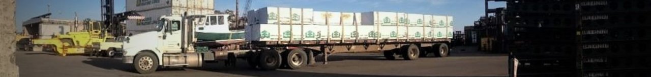

    Sorry. I turned off the computer for the weekend. I honestly can't give you too much advise without knowing the specifics of your truck and where you're hauling. In my world I'm allowed 88,000 on my truck with 38K on the drivers, and 20k on each of my spread axles. With one my trucks I can easily roll with 54K worth of wood on my trailer. Our usual load of SPF lumber is double stacked on the first 16' and double stacked on the last 20', leaving 8' of single stack in the middle. We run a 45' spread axle flat.
    This is a crappy cropped old photo of a truck I just recently retired. A 260" wb day cab specifically so that I could get the bridge formula needed to haul large loads and 60' beams without a permit. Due to the lengths of lumber in that load I put 46' worth on the bottom tier and had to center up one bundle towards the front to make the weight work. cropped-lumberload-2.jpg
