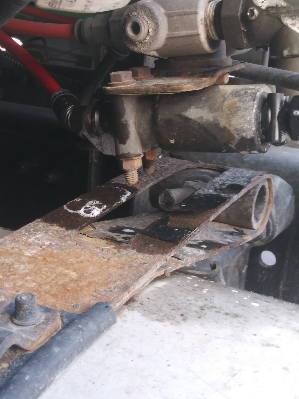

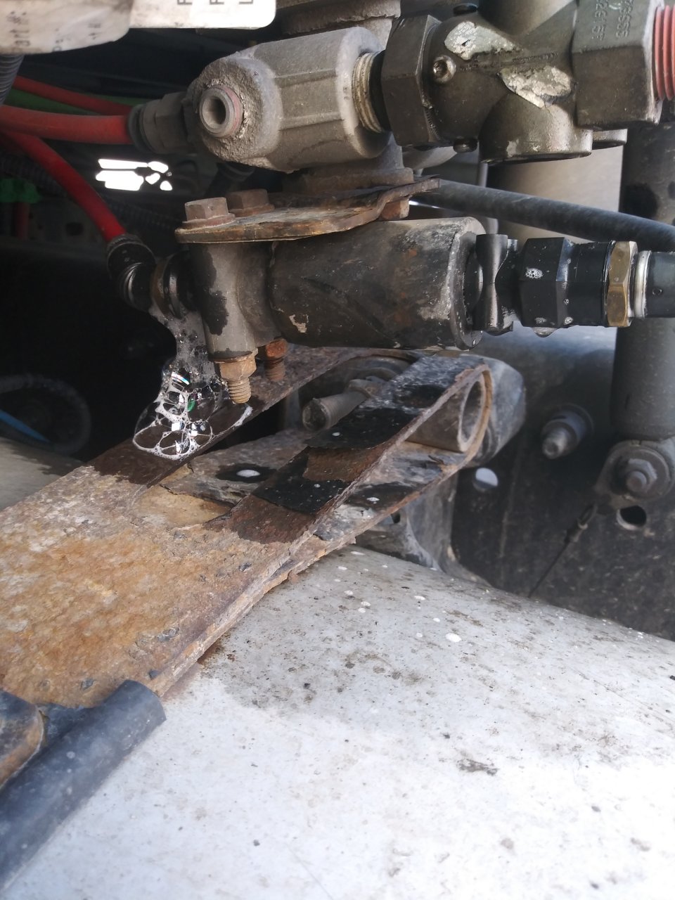

    If the pictures are no good. It's connected to the same bracket the trailer air connect to under the cab.

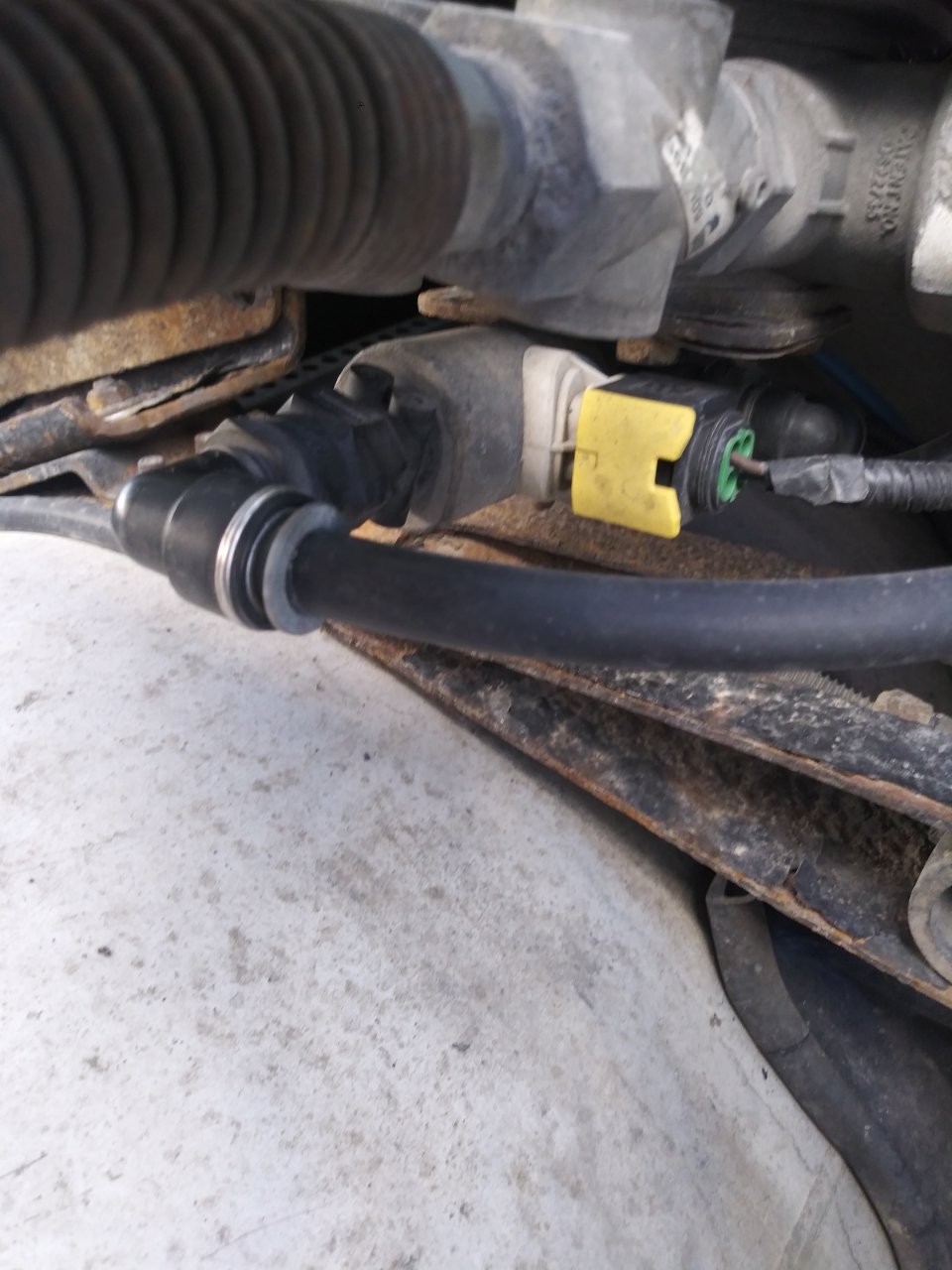

    Is that mounted on the fuel tank bracket?
  4. blairandgretchen
    13,996
    77,090
    Dec 9, 2011
    South west Missouri
    Is that yellow plug on the backside in the picture connected to it?
  5. Keepforgettingmypassword
    Keepforgettingmypassword Heavy Load Member
    738
    938
    Jan 11, 2022
    great question. I had to look. Yes it is.

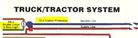

    In the first pic, upper right corner, between the white threads and orange threads is a quick release valve (QR) which threads into the tractor protection valve (TP). The valve below that I think is called the double check valve. The wires are for the trailer brake light switch.
