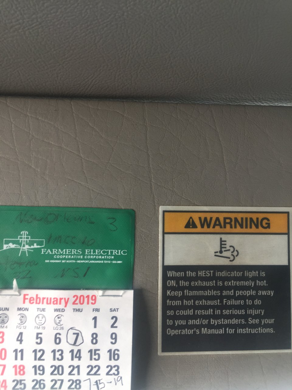

    I have a 2012 Freightliner Cascadia with Cummins ISX and the high exhaust temp light turns on every time I come to a full stop. I was having a clogged DPF and I took it to the shop and had them take it out and clean it so I'm not sure if those two are related.
    The engine sounds very rough and laggy and as soon as I start rolling at around 8 MPH the light goes away and the truck is back to normal.
    Any ideas?

    HEST is typically an indicator light that warns the operator that the engine is performing an active regeneration.
    Roberts450, flood and kameleon Thank this.

    Hest light is high exhaust temp . Basically Means it’s trying to do a regen. The light is set up to turn off at a certain mph like 5 or 7......even tho the exhaust is still hot.
    It’s meant for dummies so you don’t park and melt the siding off a bld or something like that....touch the pipe with your hand etc......
