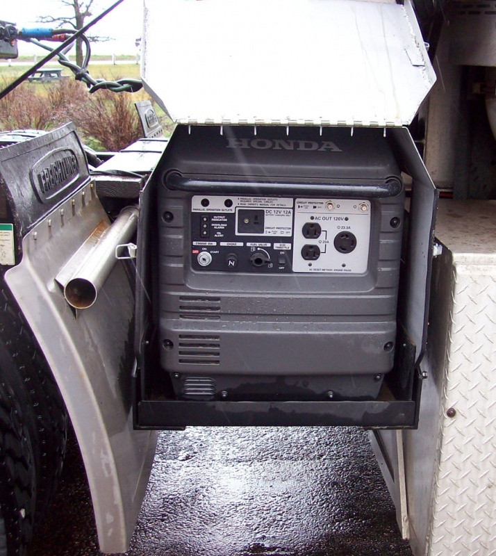

    Here is one I saw the other day. The box on the right side is what covered it when not in use. I was walking my dog when it caught my eye.
    Not bad.

    Honda EU3000is and a Dometic Commercial rooftop unit. Also have a battery charger permanently hooked up and a GFI socket inside. Works like a charm and I have @$3500 in it all including all parts and the mounts/slides/cover etc.
    Runs @12hrs on 2 gallons of gas, and will keep the interior at 68 degrees when it is over 100 outside.
