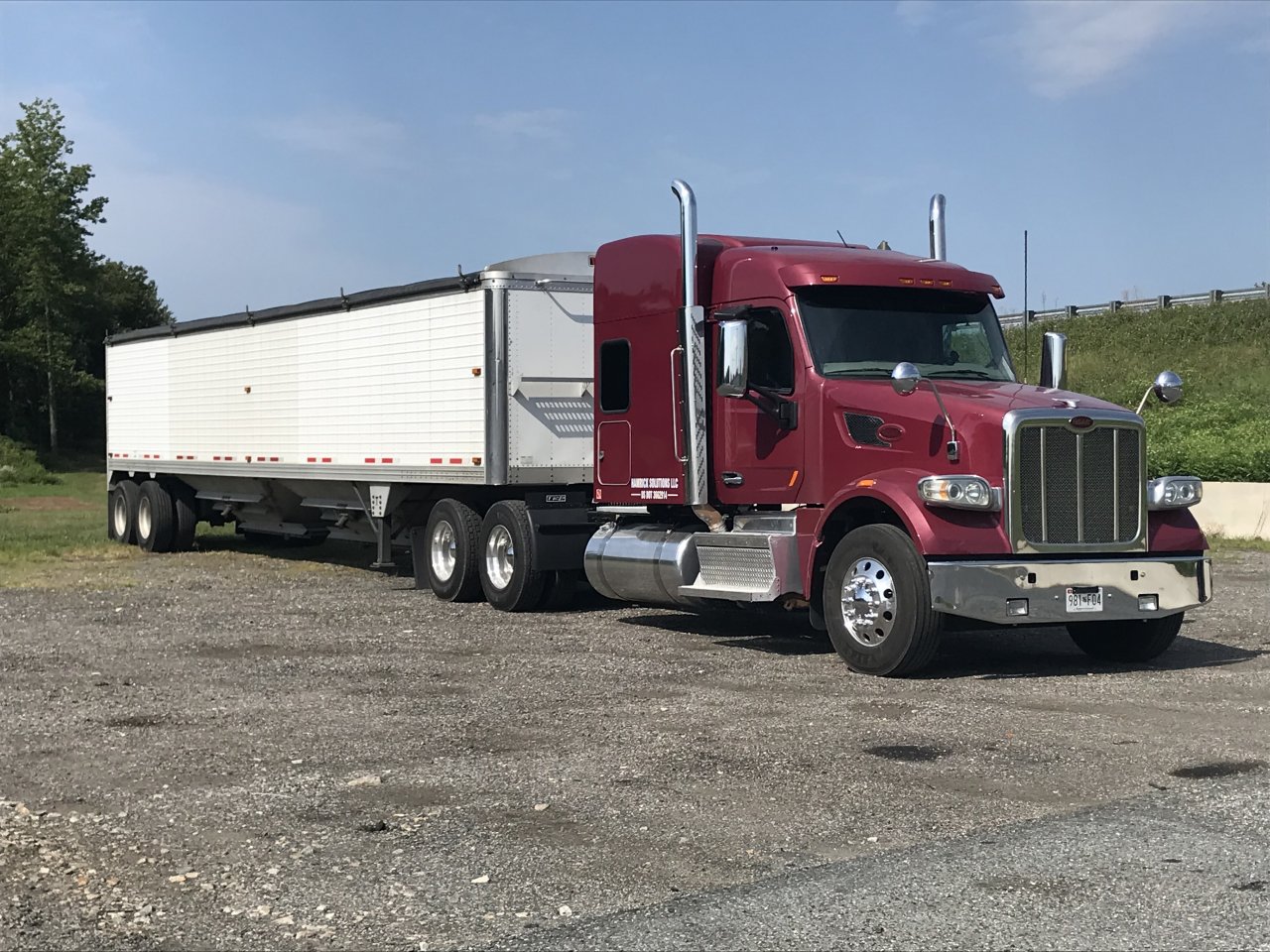

  5. redcrab
    redcrab Bobtail Member
    11
    8
    Jul 24, 2021
    This is what I got truck and trailer wise.

  6. Judge
    13,979
    93,056
    How many black tarp stops on the Timpte on driver side, 3 or 5, my Wilson has 5.
    I load right behind the second one on front hopper, infront of 4th one on back hopper, my trailer gauge loaded is 62, might be a little different on that one, but not much, can fine tune with time.
    That’s not a setback axle, so you may not get a lot of weight on steer.
    Might have to move 5th wheel up some.
    redcrab Thanks this.

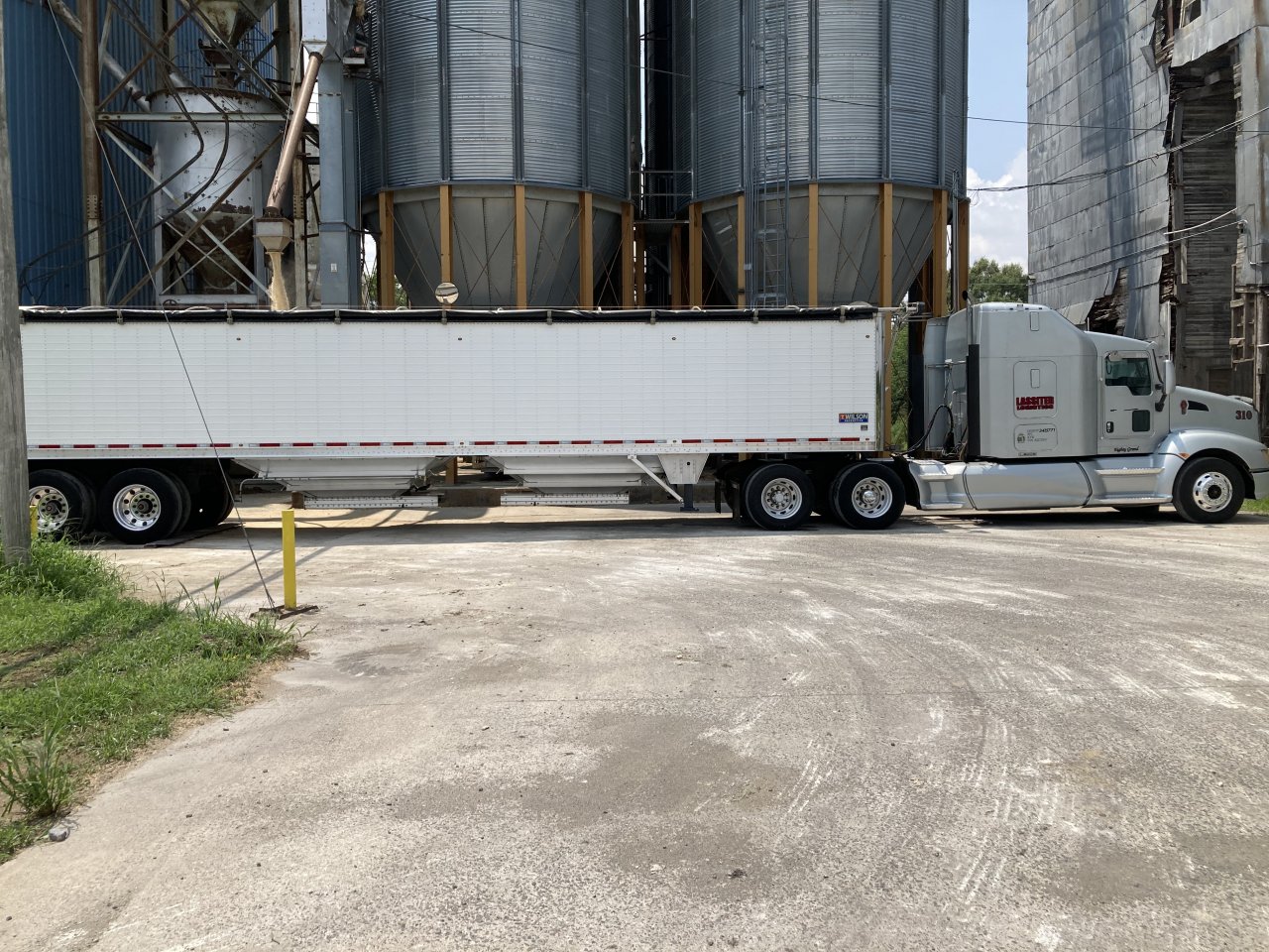

  7. Judge
    13,979
    93,056
    there’s mine, and where I load the back hopper, that’s Brewers Rice.
    Load all products same spot, rough rice you may have to add a pile of cup weight is low,
    Speed_Drums and HopperHauler Thank this.
