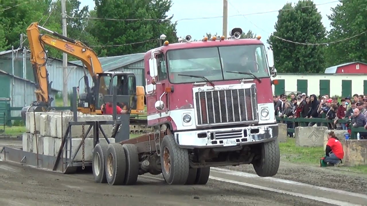

    If you aren't doing this at every stop light you need more power!
