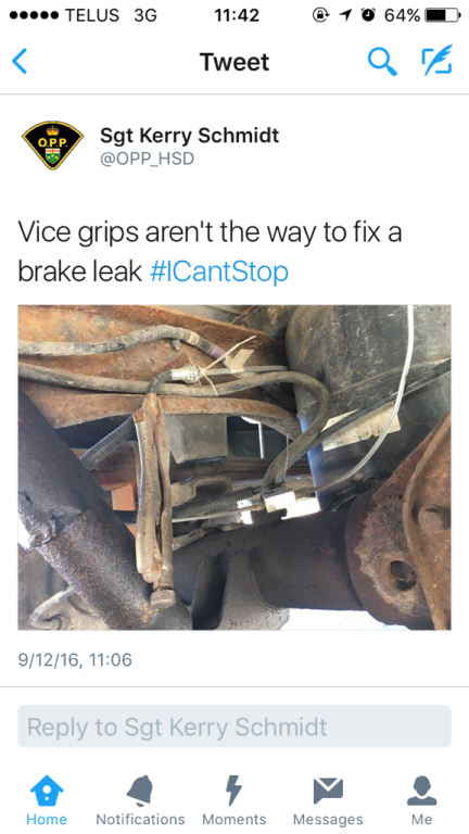

    One of my friends sent me this. I tried to explain it was a legit way to limp home. I don't know what the heck a tweet is.

    I've used visegripes a few times over the years .. if stranded up north your service call can run you 1000's of dollars .. I normally put them in place then wrap with duct tape so they can't open back off the slack and roll to the shop ...not legal but it isn't any different than running with a single brake out of adjustment and it's only temporary anyways

    There's 3 more brakes. No worries.

    If you look close I think it's a rear axle, so I'm guessing they are down to front brakes. Like I said it was sent to me, I have no issues if it's temp. A local wrecking yard used to get trucks in with all kinds of "temp" fixes that turned into long term.
