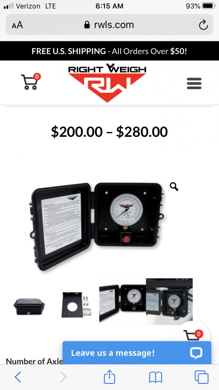

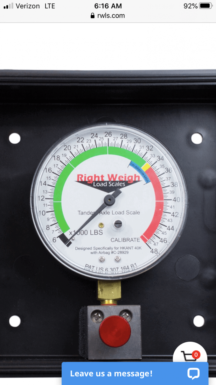

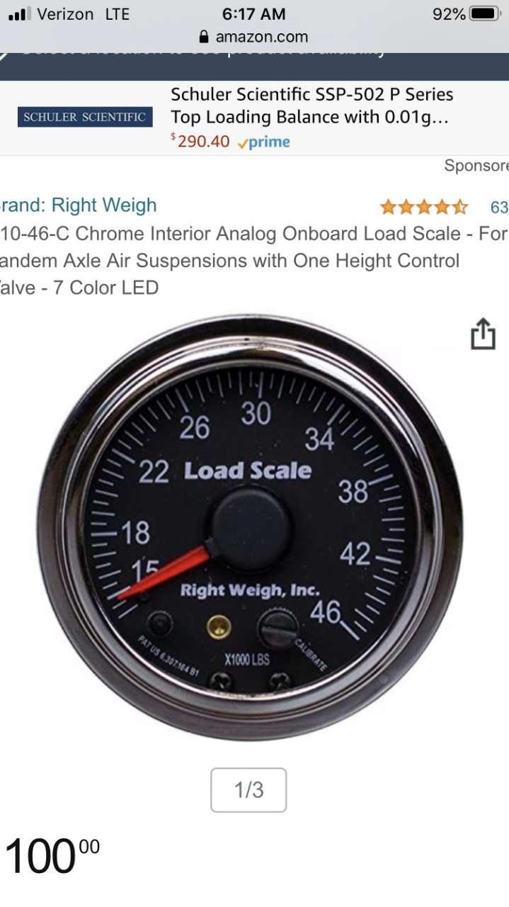

    Or get a gauge that works rightweigh had some fluid gauges that did good
    0F0C9E41-658C-47A0-B0DA-DD65857C149C.png 367A648F-6AA5-4C7F-825B-F70BD9D53637.png 77FEB148-5DC3-4B56-832F-DE5996B99494.png
    markk and Muddydog79 Thank this.

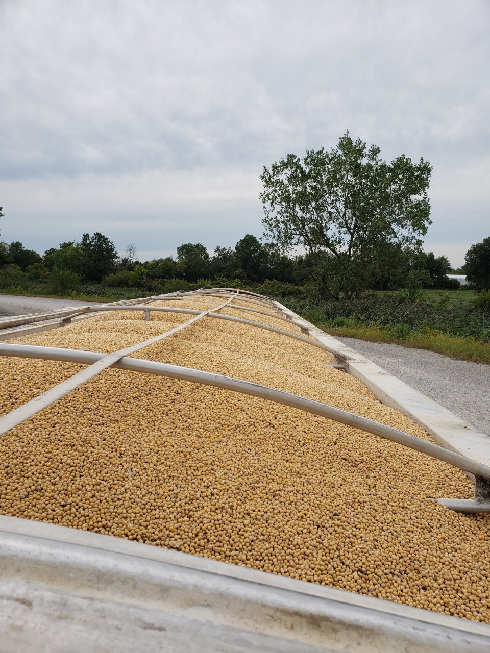

  10. jamespmack
    2017 Wilson on spring ride, I dont get paid per trip. FULL is only option. I do have a Air Weighs on my flat bed.
    I could have put alittle more on.
