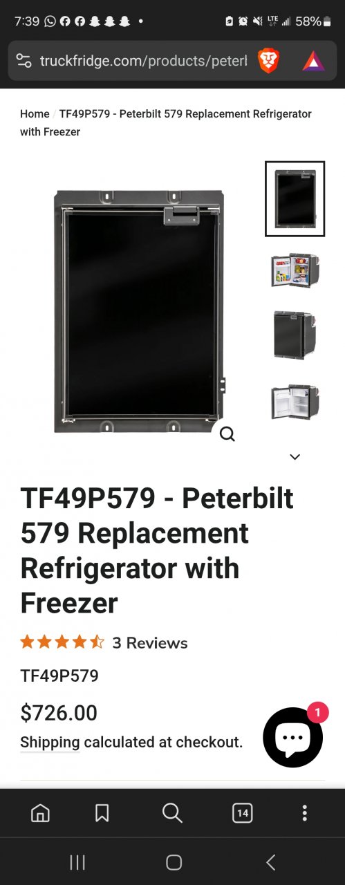

    Whoah!! Thanks a lot bro, so we always weigh the trailers before getting loaded in the Tanker world? I'll take these advice to heart cause Bynum doesn't do any training, after orientation, you got your truck then you hit the road, I have a feeling I'm gonna hate the mountains even more in Tanker, hopefully I don't roll over them LMFAO!! Don't you get overweight when you put your 5th wheel all the way to the back? Also! I'm coming from Freightliner and going to Perterbilt 579, Freightliner have enough room to put your own fridge, and I have a big one, but the Perterbilt have a small one, and the thing is Bynum's truck doesn't have fridge... I was looking at some options online and man they are expensive... So I don't know if you guys know any other options for me, maybe there's enough space for me to put my fridge in the middle, or something or will I have to eat that cost, buy it, then have the shop install it for me. That's one thing I will miss about Freightliner, you can put a big *ss fridge in there lol.

    At that price just get a domestic , iceco .

    Look at BougeRV. I have 3 of them. 2 have thousands of hours on them. Combo freezer/fridge. They are tough. Lots of hours off roading.
