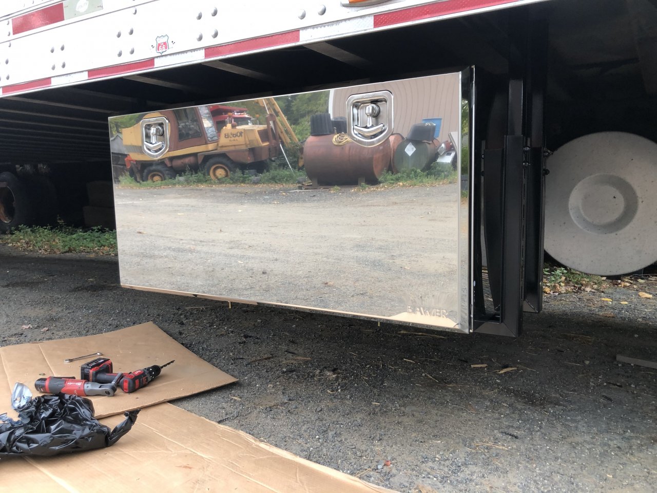

  6. abyliks
    abyliks Road Train Member
    3,064
    6,865
    May 2, 2010
    ludlow MA
    I bought one of those giant U brackets and bolted them through the crossmember with some poly from an old dump trailer liner for a spacer, 3F3830A2-7969-4E41-B9BE-1FD6549FD93E.jpeg
    OldeSkool Thanks this.
