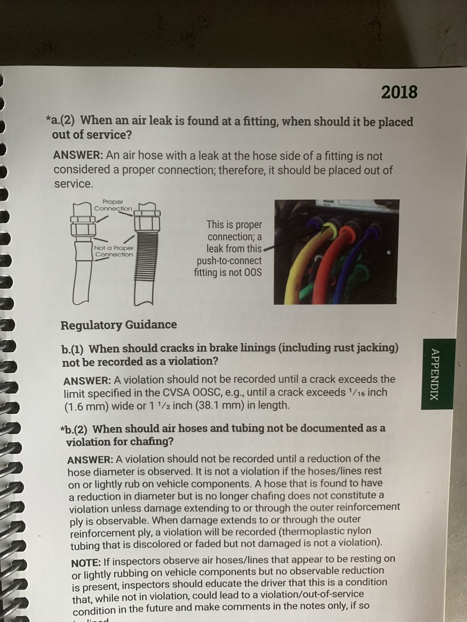

    Well yes if it is not in the exhaust mode, and who told you one kind of fitting is legal to leak and another isn't. You might need to think about that.
    Per dot any audible leak is oos, they do not distinguish what or where as far as audible air leaks come from.
    I have had dot officers let me slide with out fixing one on the spot, but that is up to the officer.
    Most recently was the exhaust port on the quick release for the steer axle brakes.

    59398949-4ED4-4ECF-AD8D-41A61562E41B.jpeg EC9D0AA5-E421-4EB3-B184-0A48B547961E.jpeg 4A4669AF-2DA0-4844-8B0C-F837CF2C14E7.jpeg
    Yeah ten4. I wonder if with brakes applied, that it puts that manifold into exhaust mode? It doesn’t seep without applied brakes.
    & Read that in the cvsa book 2018. I misread it a bit, but It’s kind of confusing, I’ll post it up. It’s like if it leaks at the fitting it’s nott oos, but at the hose into the fitting it is. I guess that would have to be proved on spot with a spray bottle and soap water lol,, to which part it’s actually leaking from.

    I do not have the regs in front of me at the time. Just a leak, seep is not oos, but somewhere in the regs it adresses, the term audible and any and all audible leaks are oos. If the dot officer can hear it, he can shut down on the spot.

    I understand that to be OS if a line is cracked on the outside of the fitting. They used the example of a push to connect fitting that was leaking at the connection. The example did not differentiate between push to connect or compression fittings. That is just my take on the deal and I could agree with that.
    My take on the deal does not matter if I get put out of service. If you can pull that stuff up on your devices, while they are checking to see if you are a registered serial killer or something it could help.
