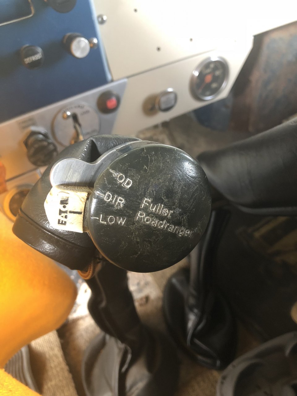

    I see it has Lo Direct and Overdrive. At first I thought it was a 9 speed but after seeing the 'splitter' on the side there makes me think it is a full 18 speed. Thoughts? 18speed.jpg

    Isn't there a duck bill under your index finger, where it says 'Fuller?'

    No range shifter duckbill just the little splitter on the side.

    Oh, wow..no clue. Guess I'm not too familiar w/the new stuff. Nice set up, tho. I'll wait for the answer along w/ you, then. :)

    It is from a 1980's GMC Astro Cabover.

    13 speed 3 postion knob. Late ‘60’s thru the mid 80’s. The chrome ones with shift pattern were usually in the o/o tucks. Plain dark grey was standard. They were the easist to use. Imo. They are all I use. I’ve put them on new trans as well.

    This is the original standard one in my ‘72 White 4000.
    Very well used but still problem free.
