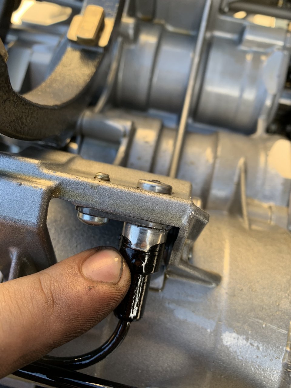

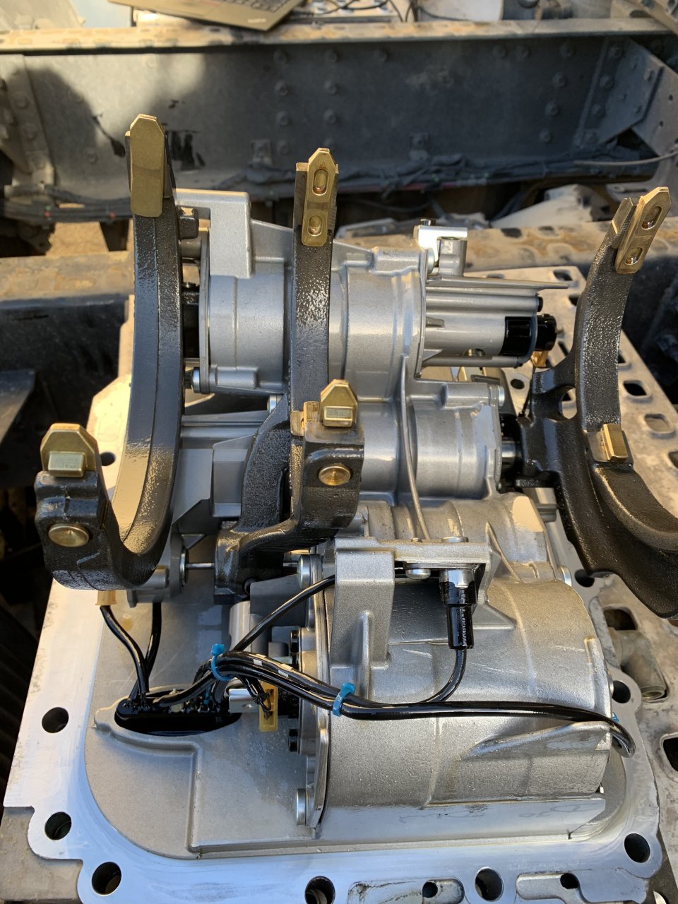

    So here is something a lot of people dont know about a problem with this ishifts, the wire harness has speed sensors build in it, most of the time the solder joints go out, PROBLEM with this is that this wire harness is internal and if you want to replace it you have to drop down trans and take apart the shifter assy on top with TCU board, to do this need volvo software and breakout wires in order to calibrate the trans, other possibility could be the main bearing in the input shaft going bad but not very likely it is this. most likely with the miles its the breach harness you have to take it somewhere were they really know these transmissions not very many shop most of the time ends up being the dealer,

    Since picture is worth 1000 words I’m actually in the process of doing one right now

    depends on who does it, you have to drop out the trans i will suggest that instead of just harness replace whole shifter housing being that it is only about 400 more than the harness. but labor i dont know what they will charge thinking at least 10hrs to r&R trans and than probably 3 or 4 to open up and close it but i dont know i usually charge about 13 hrs for this job that being said once you do it couple of times its a lot quicker.
